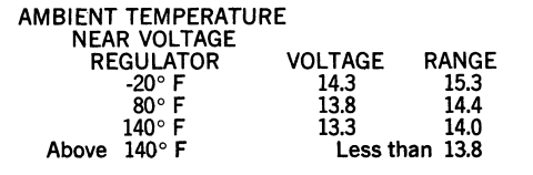

Also, if your car's system voltage is 15-16v when running, that seems high too. I'll let someone others chime in with their opinion on that, but you may want to check the operation of the regulator. For some reason, I couldn't find the spec listed in my 68 manual, but this is from a 73 Chrysler service manual. 73 had a solid state regulator but I would think the spec should be similar.

Measure the voltage directly at the battery when the car is idling, maybe a slightly fast idle like when the engine is cold. Put the volt probes directly on the battery. You don't want it higher than 14.4 volts. You really don't want it 15 volts or higher. But use a volt meter you trust. I have a separate ground wire going from the housing of the voltage regulator to the ground wire that comes off the battery cable going to the radiator support. If the voltage regulator doesn't have a good ground connection there will be problems.

Over 15 VDC certainly merits a bit of concern. Even my system, with the Powermaster alternator, a brand which several folks on this Forum have observed to run high, peaks just at 15VDC, and that seldom lasts more than an instant. A 67 Newport should have a ballast resistor of about 0.6 Ohms, with a coil impedance of 1.5 Ohms. Lower impedance in the ignition circuit, which should total at 2.1 Ohms, will draw heavy current, which, with a breaker point ignition will shorten the life of the points, and possibly the coil if it isn't supposed to pull too much. Ideally, at warmed up running temperature, the coil voltage should be ~ 3/4 of the alternator output voltage.

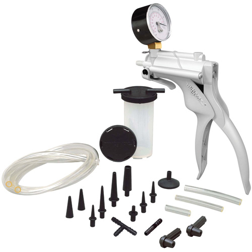

When the choke is closed cold engine use a hand vacuum pump and hook it to the choke pull off diaphragm, pump the hand pump and see how much the choke opens. Then you can adjust the small linkage with pliers to open a little wider when cold starting I use the Myte Vac for a lot of different things
