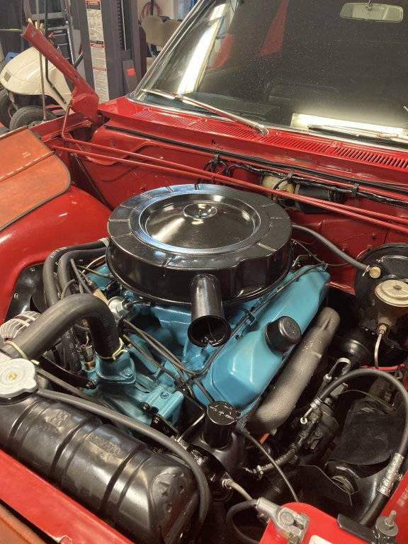

Carburetor for 1966 383
That Edelbrock coil might be the source of your woes. You DID use a GOOD ballast resistor with that coil, right? It occurs to me that an ignition coil, poorly ballasted, (mismatch) might work well for about 20 miles, get hot, have its resistance increase too much, causing it to sputter. I think you have multiple problems, with one overriding one for the moment. See if you can obtain another Stromberg WWC or Holley 2210, rebuilt, bolt it on and so forth. I suspect the fellow who did yours needs his hands removed, as a warning to others. What he perpetrated on the choke is inexcusable!
I had the problem prior to the new coil, so I have to think that is not the issue. But I will check the ballast.
