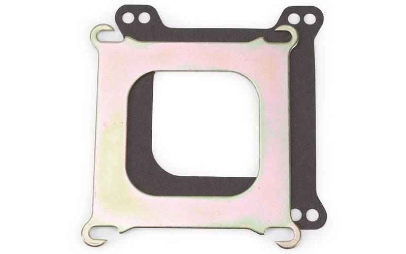

I would go with the Eddie 1406. More than enough for your low compression 440. Plug and play right out of the box. I have had a half dozen cars with them and never had to make an adjustment on the carb. There is a thin carb adapter plate that comes in the Eddie intake box. If not order a Eddie 2732 adapter.
Edelbrock adapter 2732

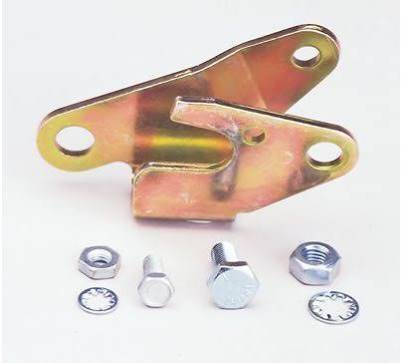

You will need a linkage adapter too.
