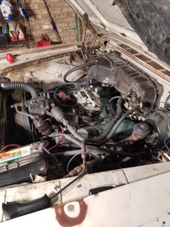

Apr 22, 2022
162
38
Fairview, TX
A little bit smokey, burning off the residual oil spill on the manifolds.
With the Carter AVS on the motor, sounds GIRTHY, and MEAN.
IT. WANTS. TO. GO.
Oh and yes, that's chopsticks holding the choke flap partially open.
Lol.
But all is well!
