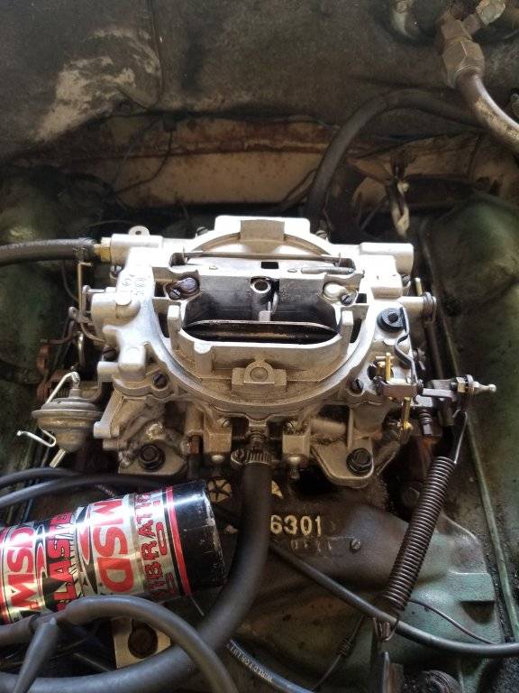

Hello gentlemen, apologies for pestering the members on this forum again so soon.
I would be grateful if you can shed some light on what may be wrong with getting the Carter AVS to work with my motor.

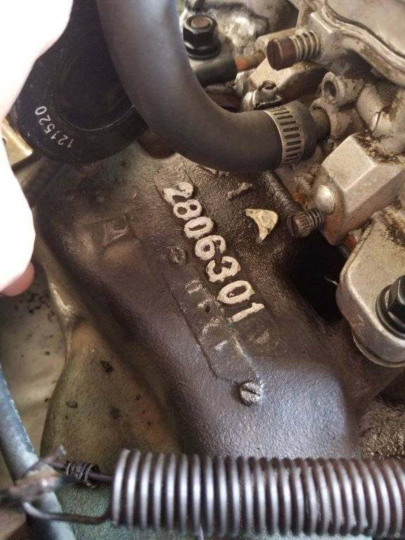

Yesterday I replaced the Lifter valley pan and converted from a 2 barrel manifold to a 4 barrel manifold, casting #2806301.
I have acquired a Carter AVS #4635S
To mount on said manifold.
Vehicle; 1964 Dodge Custom 880
The car will/may not start unless I dump half a cup worth of gas in the venturi.
If it does start it runs rough, badly shaking and will die if I do not keep revving it.
(And has a hard time re-supplying fuel to the bowls/accelerator pump)
I have done the listed minor tweaks.

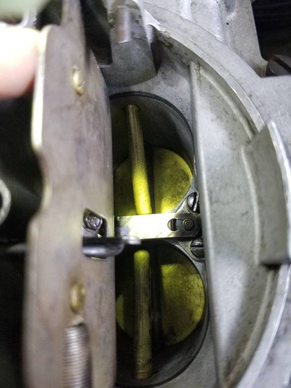

Transfer slots have been adjusted to make a "square hole" past the butterfly flap.
main discharge nozzle check ball/needle was stuck. Cleaned. Moves freely.
Carb has been rebuilt,
(Float settings copied over from uncle Tony's carb specs)
Set float drop to 1 inch
Set float level to 7/16
Idle mixture screws set 2 turns out of seat
Air bleed screw (above idle mix screw) set at 1 turn out of seat.
Vacuum ports temporarily blocked off except brake/pcv hose.
Previously when the 2 barrel was on the car, the initial is set at 18 BTDC.
Manually controlling the choke valve when and if it starts.
Currently I'm letting the starter rest, it is hot to the touch.
Much appreciated and thank you if you can talk down to an idiot like me in layman's terms.

Turn the idle speed up a few turns and see if it keeps running. Then adjust from there.

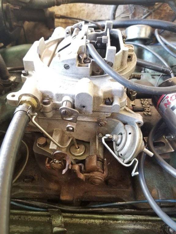

Where is the hose that goes to the choke pull off? Is the fitting open? Look at right side front corner for this fitting.

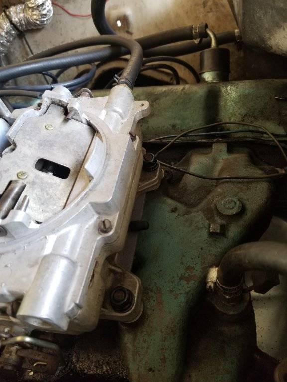

Your carb had the right front ear welded, did this damage the carb? Is the base flat so no vacuum leaks?

I'd like to say no vacuum leaks, but the engine will not start and keep running without my persistent intervention.
(I.E keeping the choke closed and dumping gas when necessary)
Yes- the choke pulloff connection is plugged off.
The carb has been repaired/welded at an unknown date.

Ok thanks. Vacuum leaks usually make the idle high, not low But I wanted to ask.
does the accelerator pump squirt fuel?

It didn't at first, I cleaned the needle valve/check ball. And it squirts but after using up the gas in the accelerator pump well, it does not re-supply with fuel.
I manually have to remove the airhorn to uncover & dribble fuel into the accelerator pump well for the pump to squirt again.
Another small detail is the fuel level is always abysmally low in the bowls, making the floats drop to their full extent.
Fuel pump works, (unknown PSI)
2 barrel carb on it a few days ago idled fine.

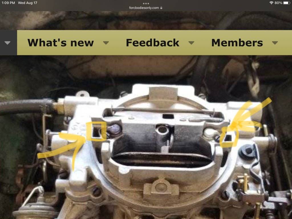

Fill the carb through these vent holes. Don’t take the top off.
make something that will fit in there without spilling fuel all over the top.
no wonder it won’t run, it’s empty of gas.

Ok, will refill fuel through those holes.

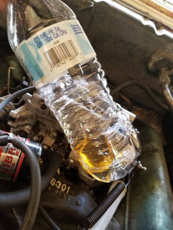

Update: I took the fuel feed hose going to the carb and stuffed it inside a plastic bottle, cranked the engine and no fuel was pumping up! How did the fuel pump fail right now out of nowhere?!
Absolutely strange.

Fuel pumps do not last indefinitely, especially once the diaphram has been exposed to ethanol'd fuels and then allowed to dry out. Once dried-out, the disphram will become brittle and fail, from what I've read several places from good knowledge sources. Getting a new fuel pump AND quality fuel pump push rod can be key in getting things to work correctly.
