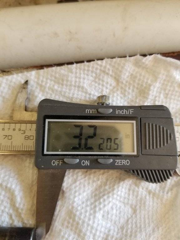

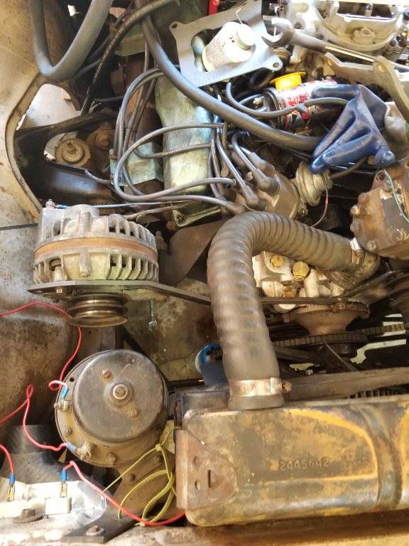

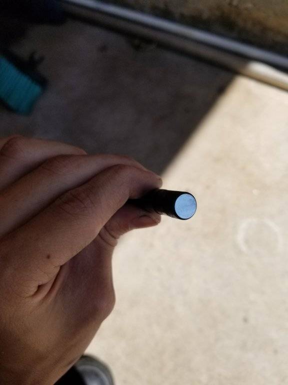

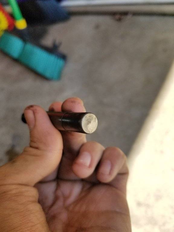

Fuel pump pushrods do wear down. I have only come across this on high milage motors. If you suspect that it is the pump or the pushrod you could buy a cheap low pressure electric fuel pump and do a temporary hock up to see if that solves your delivery problem.
There are small holes here and there on the firewall so I reckon the fuel smell was able to snake through there...When the fuel pump diaphram starts to seep, the released fuel will exit through the "weep hole" in the pump body housing. Which can also result in a fuel smell.
Agreed, as it's off of a supposed 1968 383 Plymouth Roadrunner, there were helluva lot of WOT romps.Carb has had a rough life if one of the mounting ears has been broken off and welded back on... Just Say'in.
All good, no worries mate.I meant "hook up".
That way, they get clean fuel rather than the phase-separated gunk at the bottom of the fuel tank. A CLEANER option is to head down to the big box sporting good store and get a portable fuel tank for an outboard motor boat. About 5 gallons, or less, some with even a bulb fuel pump to get things started with, too. Can be used for other things, too. But not in the "vice grip" orientation, but probably MUCH SAFER than an open bucket of gasoline.Actually I just ordered a mechanical fuel pump, but I see where your getting at.
I'll look around and see if I can find a 2 gallon Jerry can and strap a fuel pump to it.
(How vice grip garage guys start a car sitting for extended period of time) they use a Jerry can & pump also.
