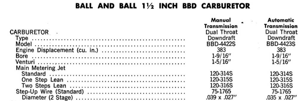

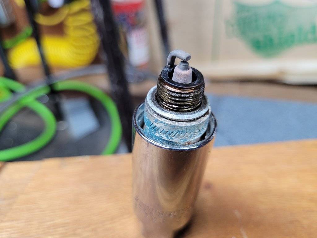

My my current carburetor I have on there I think it's off a 69/70 truck(I think). I bought it off of eBay some years ago. I don't keep track of time it all blurs together... Anyways it's causing me to run warmer than I like seeing at highway speeds around 205°f, city speeds every cools back down to around 180-185°ish. So I'm thinking I'm running lean at highway speeds. I have 3 other parts carburetors that includes my original that came with the car when I bought it back in '15. I have one set with 120-437s and two sets of 120-311s (which my original carb had) (I did see in my service manual states that the standard size is 120-314s) I'm not even sure what's in my current carburetor. So my question is what size jets should I run from my current stock?
And finding the correct size I need is non existent and buying more carburetors is a crap shoot on jet size
I set my ign timing with a vacuum gauge, which is set at 20 inches of mercury
