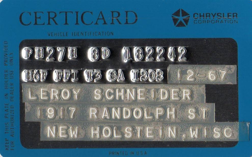

Not sure if this helps, here's mine from a 68 Fury

No real options on these, interior code, paint code, transmission, axle, build date.
All are on the fender/data tag.
Plus the VIN
The special Dymo tape might be difficult.
