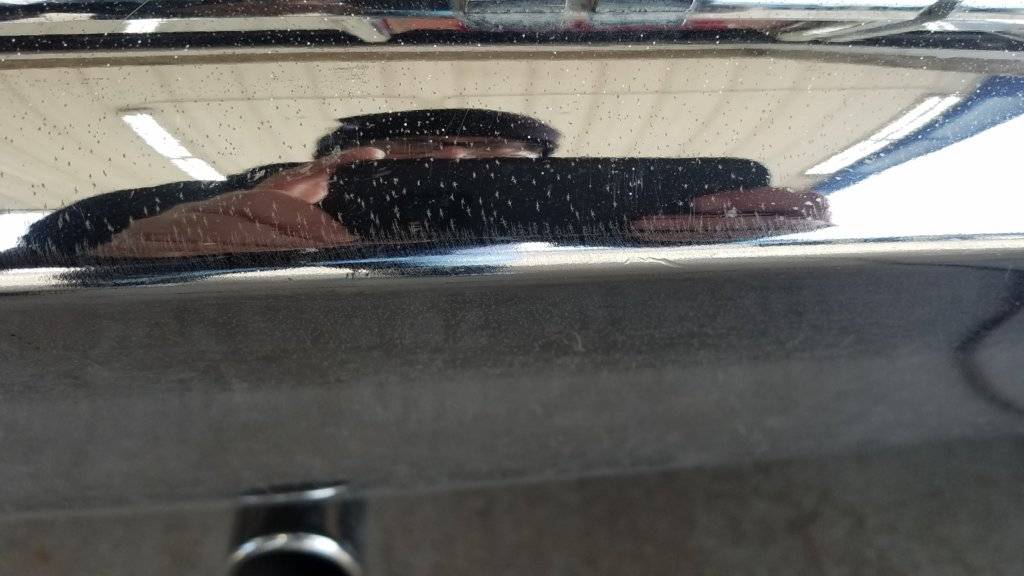

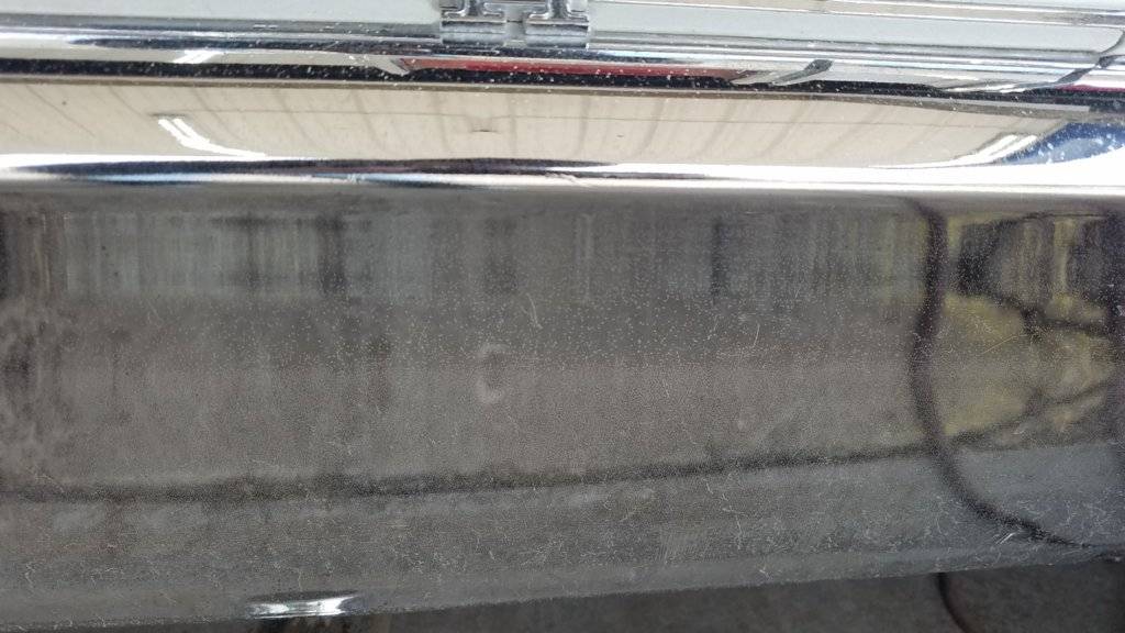

I've tried 0000 steel wool and nothing any suggestions?

You'd have to remove the bumper and then find a large enough bin to submerge it, but I know Oxalic Acid bath can remove rust like that. I've done it on chrome BMX frames before. Whether you can get it perfect or not, I'm not sure, but it does work.
not much more you can do for it. if you have some larger spots naval jelly may help some.
There is nothing you can do to make the pitting disappear. I personally think if you clean them all up and then polish the chrome, it is less noticeable if the surround chrome is nice and shiny.

I know it's expensive, but you may in the next couple of years want to just get them re-chromed. I had the same issue and tried everything except the bath and the dimples just got bigger so I ended up re-chroming.
I'll try some of the suggestion for sure. The other thought is have them powered coated chrome might be cheapest way to go and it looks like chrome also.
[QUOTE="FuryDan66, powered coated chrome might be cheapest way to go and it looks like chrome also.[/QUOTE]
NO ..... It dosent. Powder coat does not reflect.
Those "pits" are where the plating (nickle/chrome) is gone, so you can polish it forever and it isn't coming back. The only right fix is to have the bumpers re-chromed.
