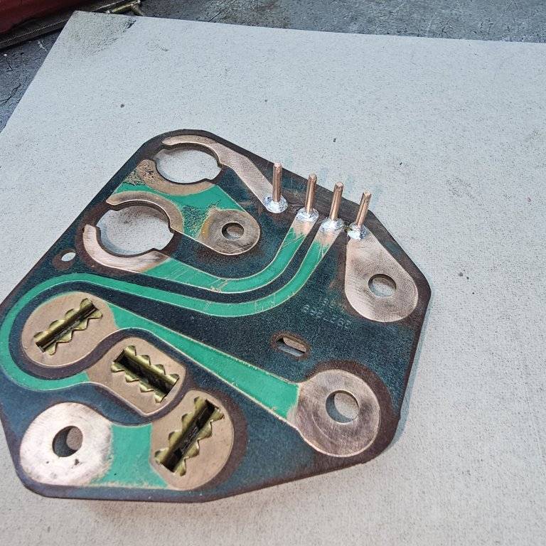

Circuit Board Terminal Fix
60Ramcharge
Nov 27, 2023
15
81
Bountiful, Utah
A great fix for those factory male terminals that are just crimped in the opposite side of the board. I used solid copper wire of same thickness and just soldered them in place. (After cleaning and fluxing the areas to be soldered).
On the back side of the board I left them sticking out about 1/16" so I could apply some epoxy to help hold them and keep them from wiggling. Very solid terminals now.
