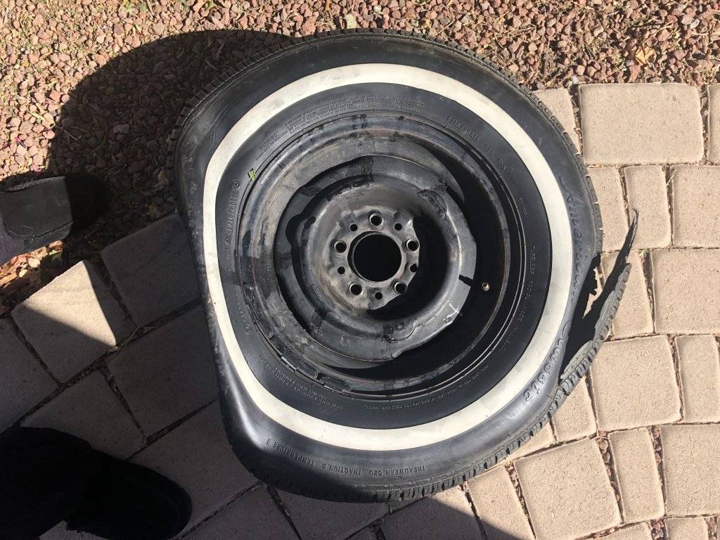

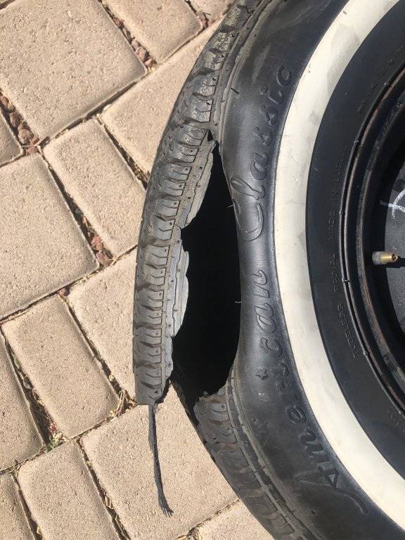

It has been 6 weeks since I ordered the Diamondback vs. the Coker which supposedly will be in today or tomorrow. In the meantime, the car has been sitting in the garage because there is so much separation the car literally goes up and down when you drive it that one would think your driving it on railroads tracks but on the ties. Discount Tire is standing behind the tires after Coker refused because I bought Discount’s extended warranty. When I drove the car over to Discount for their inspection, I was stopped at a red light and was told by someone following me “did you know your car is going up and down?”
During the last 6 weeks that the car has been sitting in the garage, one tire actually completely separated and blew out, pictures attached. I am not about to drive the car over to discount, 5 miles, but rather I will take 2 tires at a time and put the wheels and new tires on at home.
My final comment regarding Coker tires, “DON’T!” I can understand one tire going bad but all of them at the same time! Hmmmm! As I said, pictures attached!

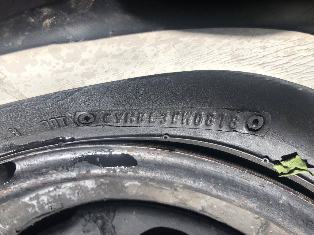

Date code decode? Tires 5 years old? For what those tires cost, they should be better than that.

They where off the car and stored inside for 3 1/2 years of those five years while the car was being restored. They went back on the car and went bad after a total of approximately 4 1/2 years including the 3 1/2 years. They have approximately 1,200 miles on them and the spare also went bad and has never been on the car. There had to be something wrong when they were manufactured and it is unbelievable Coker hid behind a warranty which ironically stated they are covered for manufacturing flaws “for the life of the tire.” I guess “life” is one of those 60 days or 60 miles whatever comes first.!
