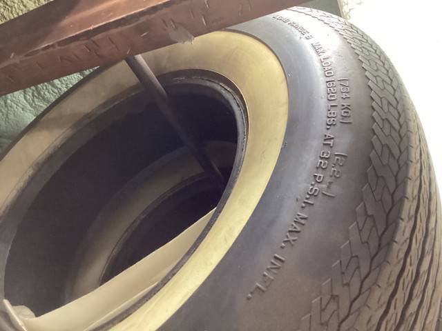

I'm going to have to start looking into tires for my '67 Monaco. The current Uniroyal tires have been damaged by going flat, they remarkably came back to life when re-inflated, but I wouldn't trust them on the highway. I need to double-check but I think I'm looking for G78-14 (it's either G or H). I know the proper tire should have 1" white-wall, but I've stumbled across these:
The only name on them seems to be "Commander". I'm thinking these were made by Coker. The ad says 3" white wall, asking price is $650 (CAD) for the set, but I my first offer (and probably only offer) would be $400. Since they are marked in both LBS and KG I would imagine they are not old, but still maybe 10, 15 years old? Seller says they've never been put on a rim. The ad was only posted 3 days ago.

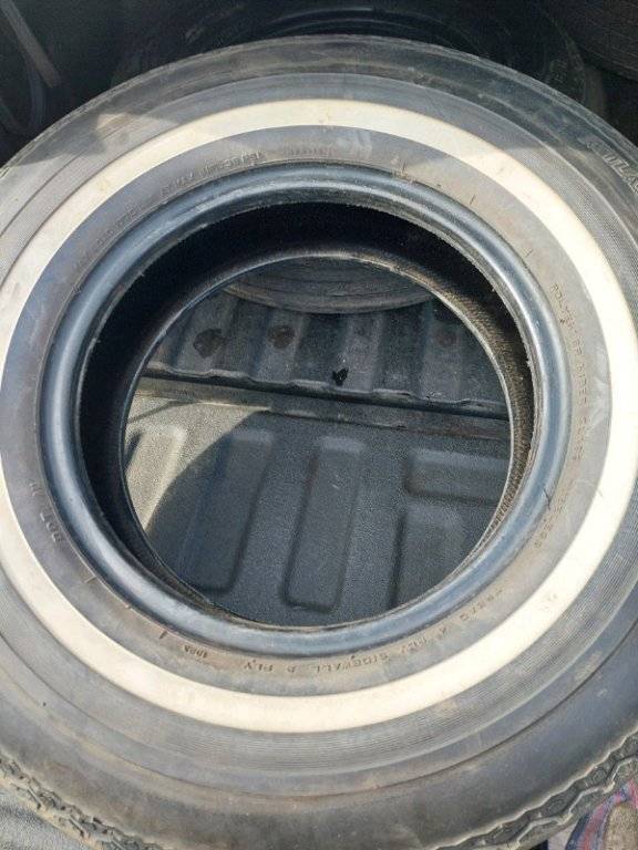

Another option are these tires:
They are H78-15. I think I have a set of 15" rims, but not a proper Dodge hubcap, let alone a Monaco 15" hubcap. I'm not even sure if a '67 Monaco could be had with 15" rims. I have Plymouth hubcaps for 15" rims. These tires definately look 30+ years old, no metric markings on them, but I can't see the name. Asking is $100 for all 4 tires.
If anyone here in Ontario (or Canada) can point me to a source for suitable vintage tires let me know.
I'm wanting to be talked out of buying the wide whitewalls because they just wouldn't look right ...

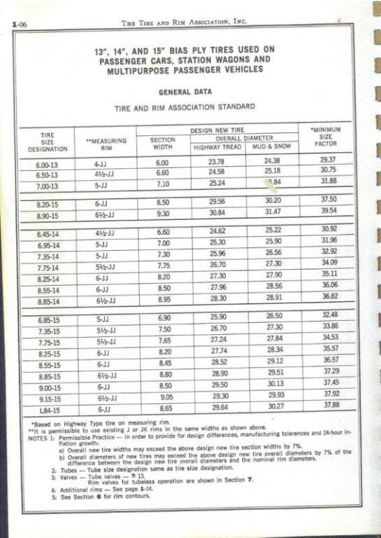

Respectfully, some of your information (#4 above) is a modern take on prior specs, which can make it a bit dated and inaccurate, from what I've seen since 1968.
Yes, tires used to be rated in inches of section width. The 8.25x14 tire was supposed to be 8.25" wide, although no government standards existed at that time.
The alpha-numeric system started with the 1968 model year. A letter for total weight capacity, numbers for the aspect ratio and rim diameter. From an article in CAR LIFE magazine about this, it was stated that the letters would make it easier for replacement tire purchasers to make sure they got a tire with enough weight capacity for their vehicle. Also, "Minimum Tire Size" decals started to appear on the lower B-pillar area of the lh front door, plus pressure recommendations, too. NO need to look at an owners manual for these things. The orientation being that the minimum tire size at the stated (minimum) tire inflations would be enough to carry the weight of the car, passengers, and trunk loadings. In some cases, OEMs had equipped vehicles with tires a notch too small in prior times, relying on the dealers to order the better size (which many obvioisly did not). So this was about tire safety, in many cases.
Radial tires, before 1968 and afterward, were listed in metric (millimeter) sizes for the section width, but later included aspect ratio, too. Hence, normal radial would be "215x14" or "215/70x14". NO P-metric designations yet!
So, you can convert the old "inches" width to Metric width by . . . Inches x 25.4 = metric width. Then as now.

No - the guy is asking $650 for the set of 4 tires (the first pic in the first post). And those are CanBux. And that's no tax. It's about a 200 mile round trip drive for me though.

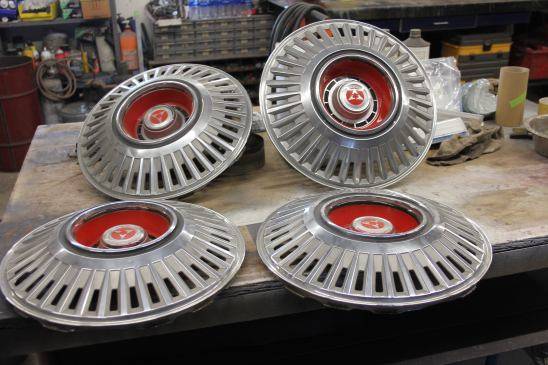

Find yourself a set of 15x7 Diplomat or 5Th Ave wheels. Still very common and reasonably priced.

Wheel covers can be bought one at a time gradually. Put the word out and I am sure people will find covers for 15" The ride will be great.
