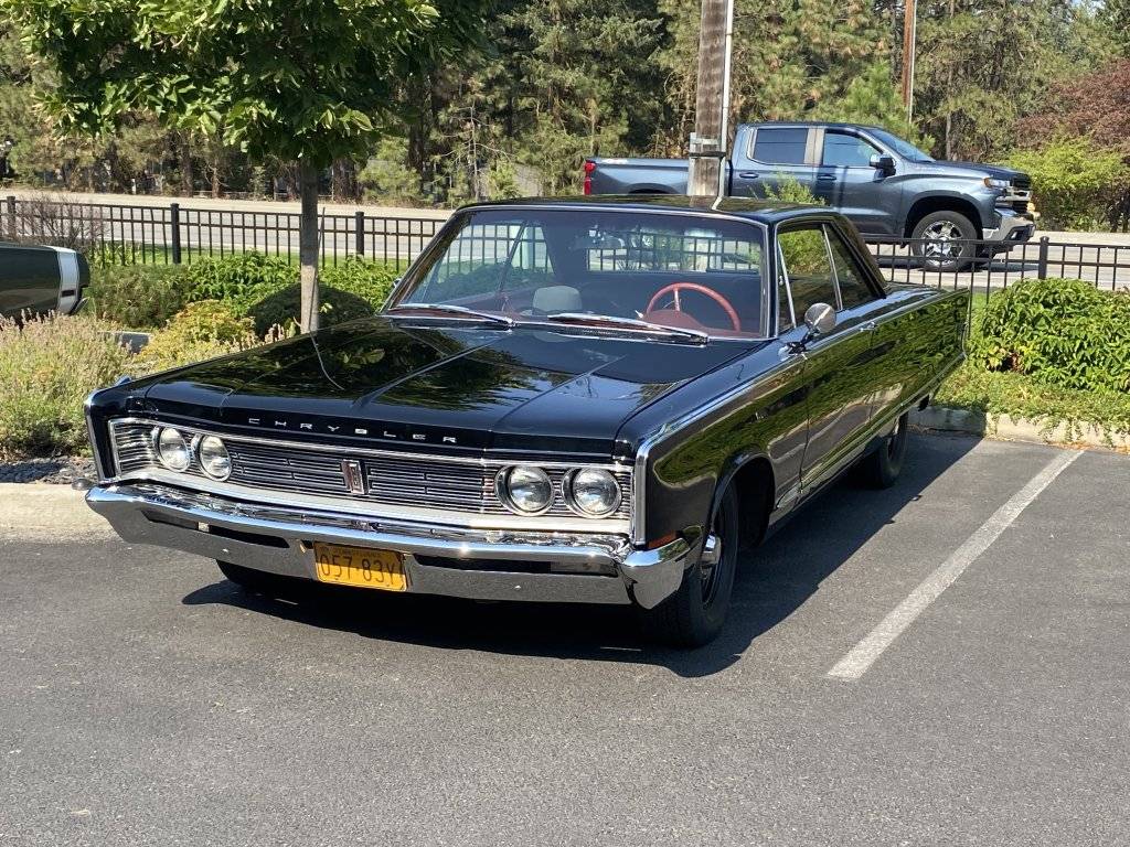

Hey guys, I'm still battling too much condensation inside my '66 Newport.
To recap - it's parked outdoors, on a concrete pad, under a cloth car cover. There is no roof over the car. Outdoor temperatures are hovering between 25F and 35F with occasional rain and snow.
I think the car cover is making things worse. I think it holds the heat in the car from what little daytime sunlight/heat we get right now. I rolled the windows half way down, bought 2 of the Damp-Rid moisture things, one for the trunk, one for the interior, and water is still literally just dripping from the headliner and is all along the perimeter of the headliner trim. The Damp-Rid things don't seem to be doing much.
The inside of the trunk lid is also soaking wet and dripping onto the trunk carpet.
I think this has been an issue with the car for a very long time, because when I got it, all of the interior chrome pieces had surface rust, and the painted metal trim for the A and B pillars also showed signs of rust at the bottom of each piece. The sun visor brackets were rusty, as was the rear view mirror. I remember when I first brought the car home last January, I thought there was a roof leak, but it was actually condensation building up on the headliner.
For whatever reason, this car seems to hold the moisture in.
My question for your at this moment is: should I take the car cover OFF and just let the car sit in the open, with the wing windows cracked for air flow? I'm thinking this will help keep the interior as cold as the exterior.
Thanks in advance for your collective wisdom.

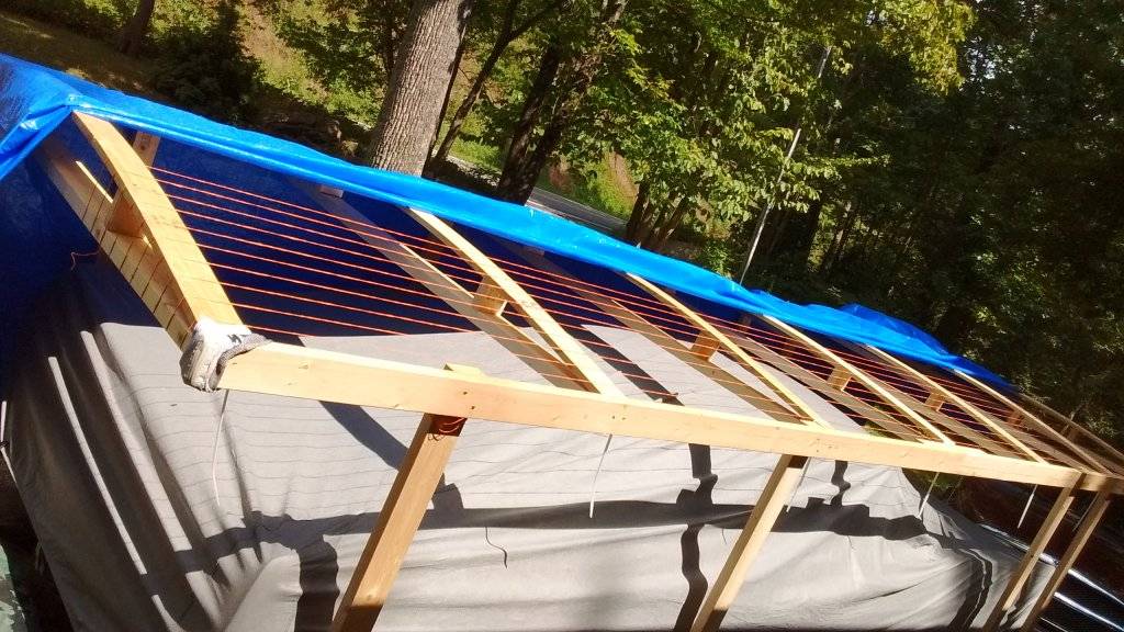

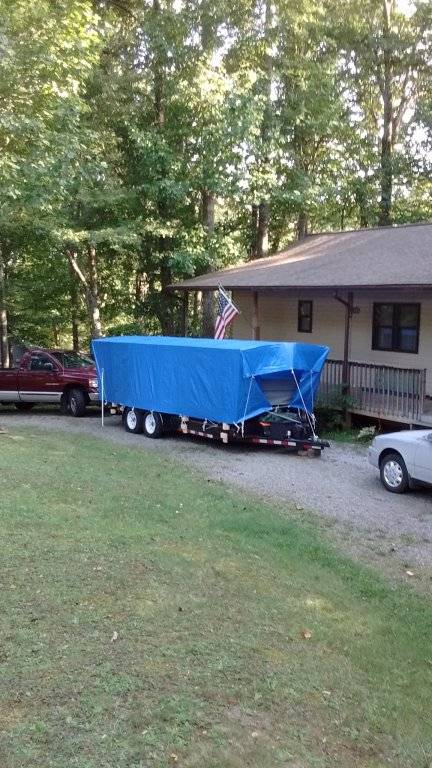

Just my thoughts. I'm no Guru...Wow, there's a lot to address here. I have had lots of experience with this sort of issue. Don't know where to start...with a concrete slab (visqueened or not), outer car body, inner car body, a garden shovel...a lawn mower....what ever. When it is chilled, then warmed relatively quickly, as the weather does, condensation IS going to form on the surfaces...unless you are in a very low to no Humidity condition. With a good flow of air across the surfaces of these objects, the condensation is going to have a chance to more quickly evaporate...no breeze to carry away moisture results in less evaporation. Less evap, more collection, then running drips and eventual puddles.
DeHumidifier inside of the car vs. the risk of a power cord to the car. Dehumidifier wins in my book. A good Outdoor 14/3 is more than sufficient. Just take care of how you route it across the porch, or yard. Don't run it through the dog pen or set it up so the wife trips over it.., etc. etc. Also, there's enough give in the doorseal to allow the cord to sneak into the inside of the cabin. Just take your time and find the best spot to sneak it in. Next is to position the Dehumidifier in a vertical position, as true vertical as possible, so it drips from the coil into the collector bucket properly. If putting it on a floor board, I suggest raising it up on small blocks so as not to smother the carpet beneath it.., then slightly change its location from time to time. You will be amazed at the amount of water contained in your car, no doubt. If you can get a "full-sized" dehumidifier in there , great. If not, they do make a small one that runs on 110V. It's about the 1.5 times the size of a shoebox, with a pretty small collector tank which needs emptying at least once every other day (in my experience). About the power cord....I mean, you would run a cord to the car for a battery charger....right?
Car covers...to breathe or not to breathe, permeable or non permeable. Keep the water from contacting the car be it rain or snow or fog...or worry about the cover acting as tent, capturing rising (Evaporated!) ground moisture from below on the inside of the cover. You can't just worry about the one (and succeed)...you've got to address both.
If the car has got to be outside and on the ground...I can't think of anything better than a concrete pad. Gravel is no better than parking it on grass/dirt. Tons of moisture come up from the ground. Concrete will severely limit the amount of moisture approaching the under side of the vehicle. Yes, you can even put HF Tarp over the concrete before you park on it, and it will add protection. But remember, if the pad gets cold, and then warm.., it's going to sweat. Period. (as will everything else). [I have also had great results by tarping the grass, then parking the trailer (with the car on it) on the Tarp. Use HF Tent Stakes]
The cover; my experience tells me 100% Waterproof is much better than a "Breeeethinggg" cover. If you want Breeeethingggg, just throw a sheet over the car. If you do everything you can to limit the moisture coming "UP" at the car, from down below, you will limit the amount that the catches under the cover, and with the dehumidifier working to keep everything beneath the cover dryer....well, you'll be doing almost all that you can do.
Almost, but not quite. You COULD put the car on a trailer and build a Conestoga over it....or you could buy an enclosed trailer...but, until that car is housed in a heated garage, you will always fight moisture to a greater or lesser extent. Luckily, in your case, you have room for lots of improvement.
