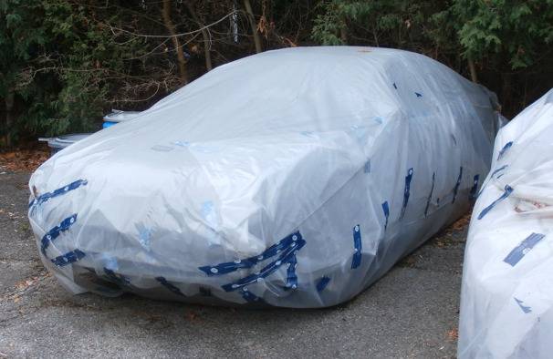

I posted this pic maybe a week ago in another thread. This is what I'm doing for the past year or two since I've had these cars outside (300m's):
Wrapped under and over with 6-mil vapor barrier. Under that is an indoor-quality car cover (non-woven polyethelene fabric). My goal here is to keep rain / snow from touching the car, and to keep the ground-level humid air from attacking the undercarriage.

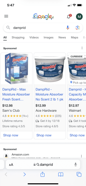

unless you are in a controlled stable climate you will get condensation as the temperature changes. Try a couple of boxes of Damprid it may help reduce the internal condensation.
Just FYI, damprid is almost 100% calcium chloride, which is cheaper if you buy it in the form of outdoor ice melter. You have to suspend or place the granules in a tray over a plastic tray or bucket to catch the slurry that results as water it taken out of the air. The slurry is very corrosive. The truck drivers that spread calcuim chloride on roads say that everything that touches the CaCl (pumps and even the pump motors) only lasts a year and turns to a pile of rust.

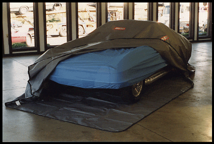

For $380 you can buy a "car bag" - a weatherproof zippered bag that totally encloses your car. It comes with a desiccant packet of unknown material.
About the only other thing you could do after the car is in the bag is flood the bag with nitrogen before you close it up.

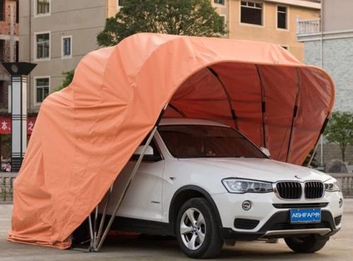

While on the subject of outdoor car storage, I have been curious about these retractable / foldable car shelters, their availability seems limited, those that are available are expensive ($3k to $5k on amazon). If anyone here has one of these I'd like to know more about it.
Considering the increase in wind speed and increased possibilities of large of hail, not to mention tornadoes, I'd be wondering about the resistance of that covering to such? Plus how firmly it is anchored into the ground. I'm sure it would work well in some upscale venues, but weather "knows no boundaries".

I looked at those clam shell units. The price was so low on what I saw it can’t be good quality. And the bigger it gets for a large car the stronger in needs to be to stay intact.
Were @darth_linux lives they get big amounts of snow, it would collapse that thing in no time with that flat roof design. Where he lives they have already had snow and been in the teens overnight. Real winter.
