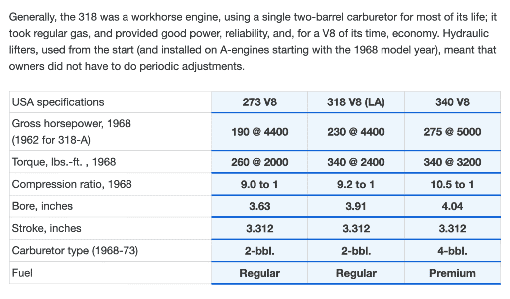

5.2 Magnums were rated at 220-230 hp depending on year, roughly a 50hp increase over the highest 175hp rating of the 318-4 copcar engines. 60s-70s 318s aren't anywhere close to compare.
A 5.2 or 5.9 Magnum is a main piece to turn an 81-83 Imperial into the equivalent of a Lincoln Mark VII LSC. Having owned 2 LSCs, and tweaking them a bit, they are a fabulous driver's machine.
