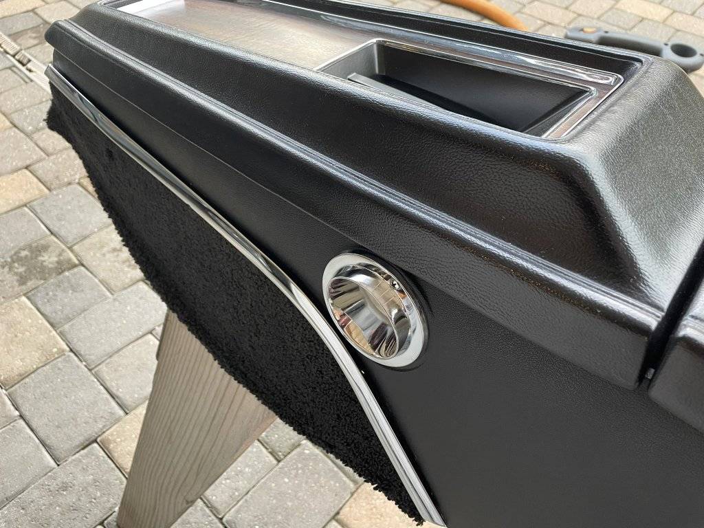

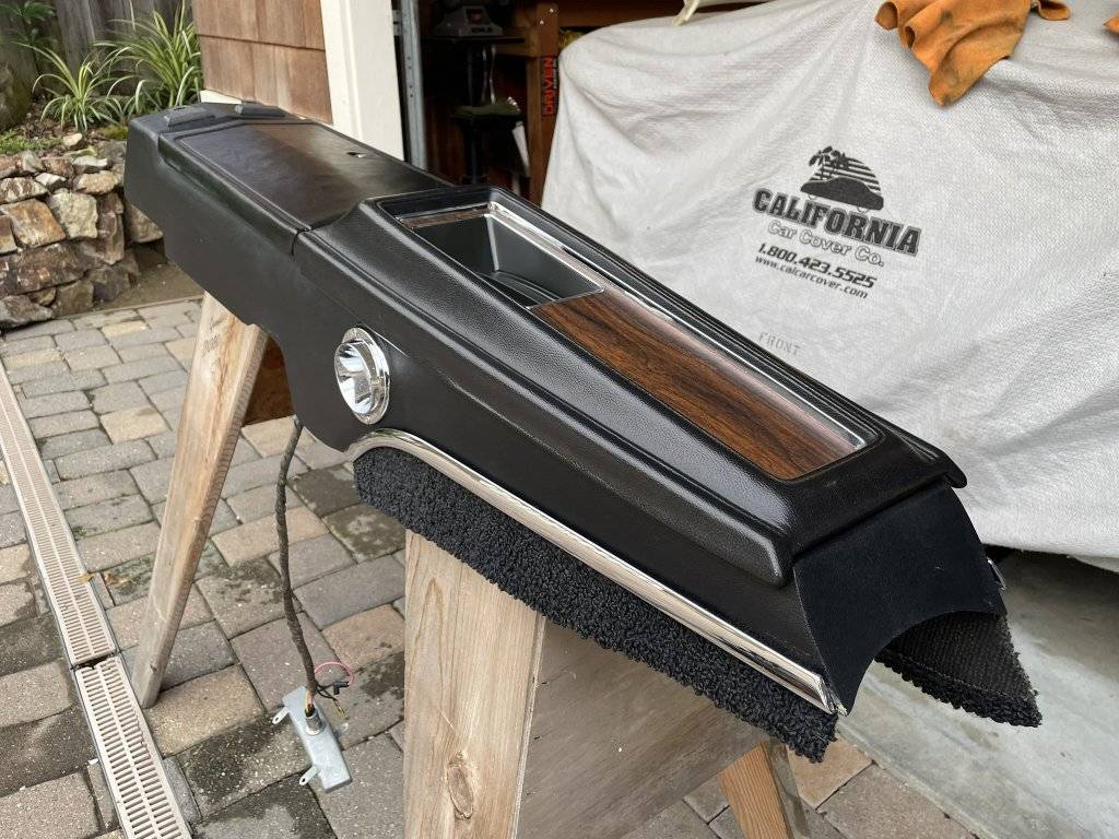

I am looking for some of your console pics, installed in car.
In particular, I am curious as to how the carpet glued onto the sides at the front drapes down and over the floor carpet....
Just finish the "resto" on mine...

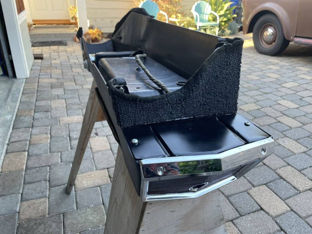

I'm not 100% sure if this helps... Your carpet looks right to me. It just drapes down over the hump and that's it. Glued to the console only. It's slightly offset towards the driver, so one side is longer than the other.

Rather than "drapes", I suspect the carpet will "just touch" the existing floor carpet. Otherwise you'd have an unfinished carpet edge to look at instead of a basic continuation of the console carpet.

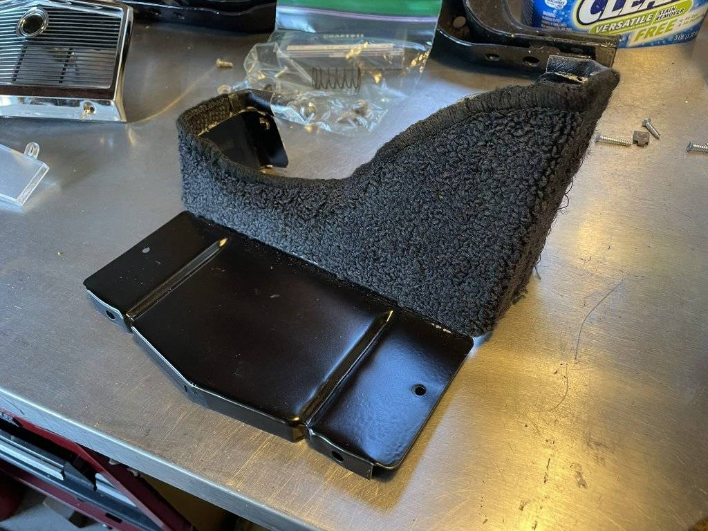

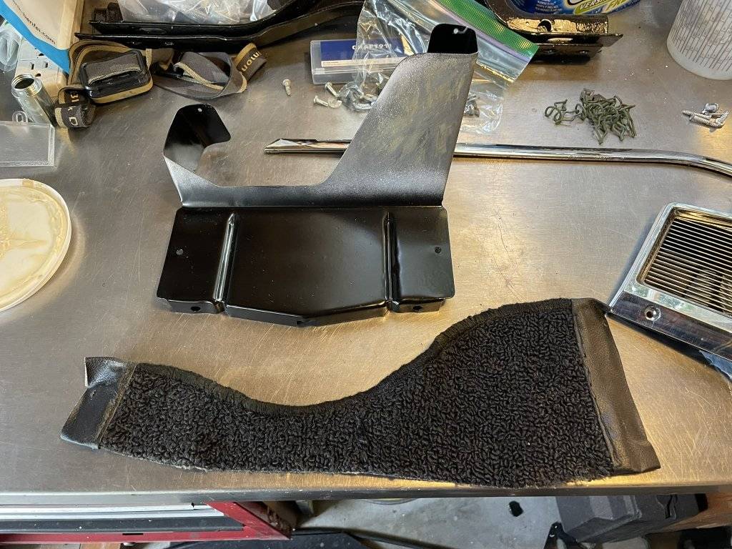

That's what I was thinking. Instead it makes a right turn at the floor and then goes laterally for about 1" each side. These are all OEM materials installed back in the same locations...
I added dynamat to the floors so they raised up very slightly slightly to meet the console just a tad sooner.... maybe 3/32".
