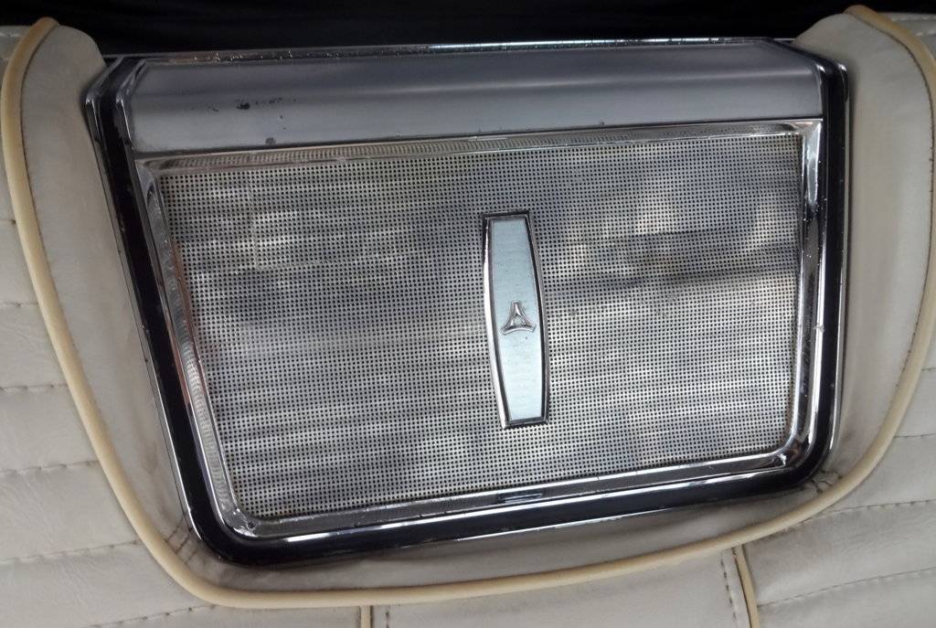

I need a decent rear seat speaker grille for my 67 Polara. I believe 67/68/69/70 Plymouth, Dodge and Chrysler C body convertibles are all interchangeable aside from the emblem, which can be switched.
I'll post a picture a little later.
There was a fella here that made some a couple years back, haven't seen him around in forever though.

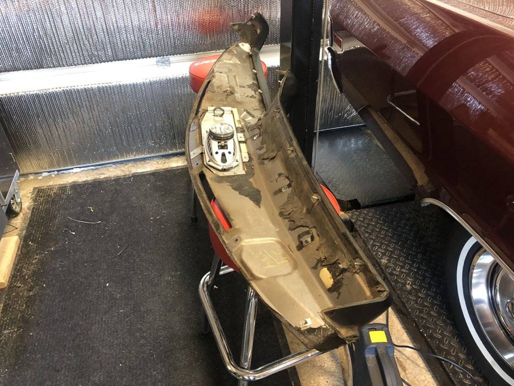

I was able to source the expanded metal to repair mine but it would be a monumental project. The screen is held in place to the pot metal frame with what looks like at least 10,000, (well a lot anyways), peened over pegs. Each would need to be drilled and replaced with small sheet metal screws. Or epoxyed in place. Not sure I've ever seen a good one.

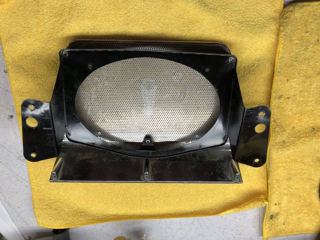

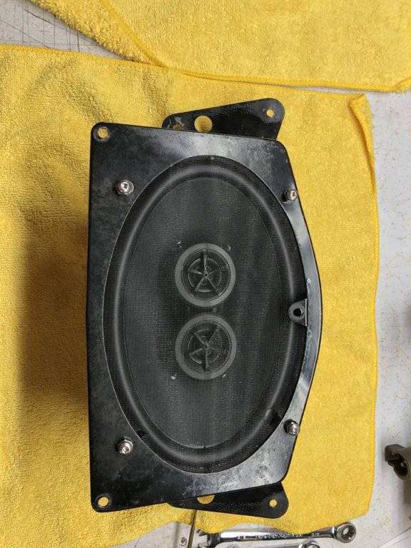

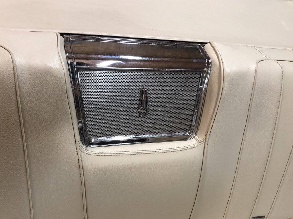

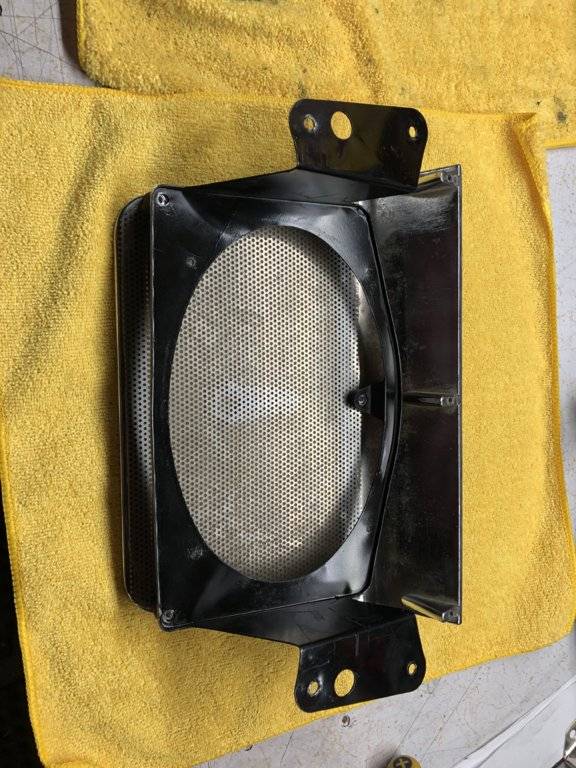

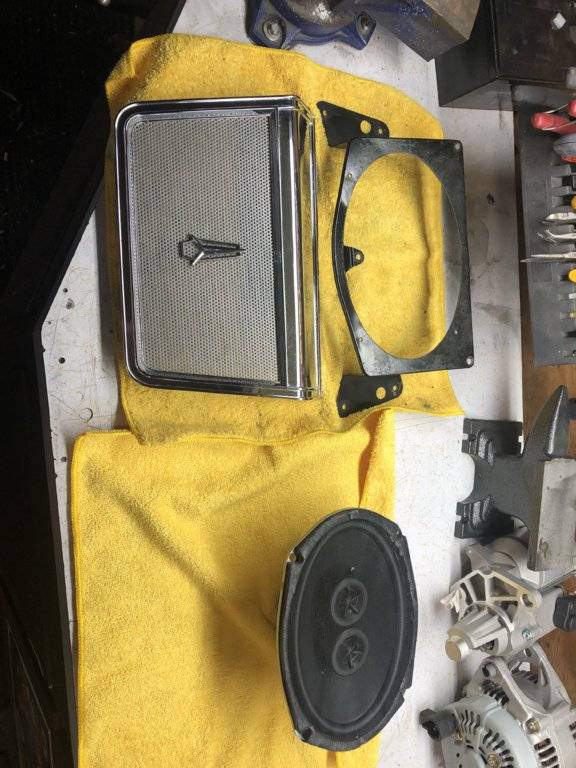

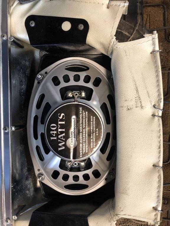

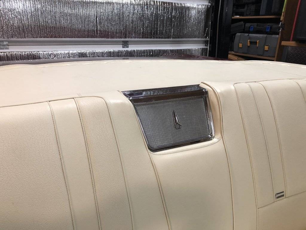

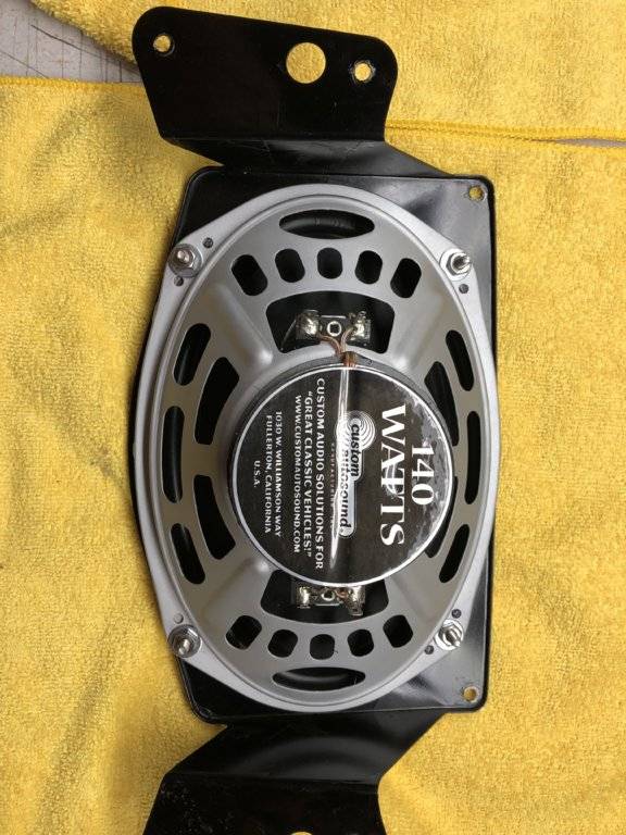

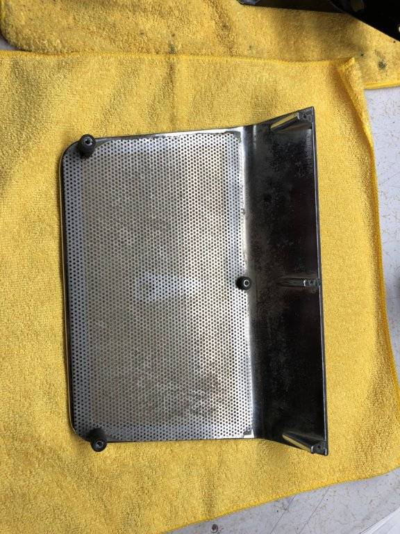

I made one out of perforated stainless steel. For me it worked well, it is a lot stronger than the Perforated aluminum , it will never rust and can be painted black if needed. I think it cost me $12 for enough to do 2 grills. I left mine the stainless finish because I liked the contrasting look with the chrome frame and center emblem. I should have washed the back of the grill it’s quite dirty , maybe next time . I was installing a dual voice coil speaker .

Where did you get the stainless screen?
What size are the holes?
Well up here in Alberta I went to a place called Metal Supermarkets. https://www.metalsupermarkets.com/ It’s a metal supply business that deals with specialty metals cut to order. I don’t recall the hole size off hand ( I think it was 1/16 or 3/32 ) . It was 3/32 thick and I bought a piece 12”x 24” then trimmed it to fit with a pair of metal snips . As far as your shackles go I wouldn’t recommend welding them together, instead get your springs re-arched at a local spring shop . It’s safer and you will won’t throw out your steering alignment.

Don’t you just love it when someone tries to Gouge you, the sad thing is he probably sold a half dozen of them. Go with the stainless you won’t be disappointed . If so desired the stainless can be polished to a mirror finish for a added touch .
Back then that grille was often the very first thing messed up on a brand new car.
Fill that new convert with a bunch of H.S. kids and someone is bound to elbow that thing or hit it with their head messing around.

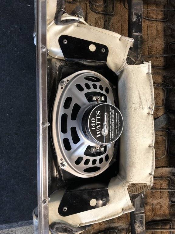

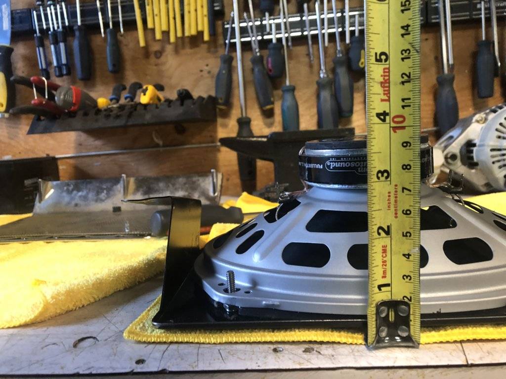

And that dual coil speaker is the exact one I bought for the Monaco. 6”x9” in back with the 4”x10” in the dash.

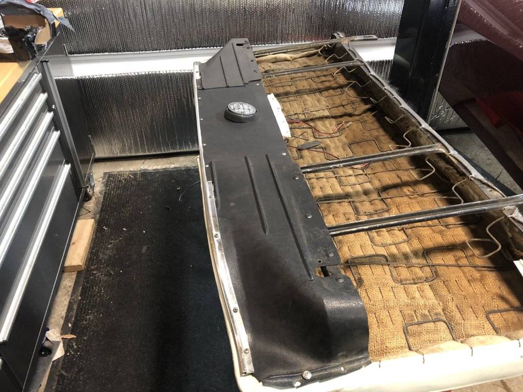

Good idea. I have the same issue with my cover panel. I'm not sure I want to cut the original so will likely make a replacement to clear the speaker magnet.
I'm also wondering about rear window clearance when lowering the top. Has that been an issue?
The 67 filler panel is a little different. It's flat all the way across and die cut from heavy laminated paper material.
