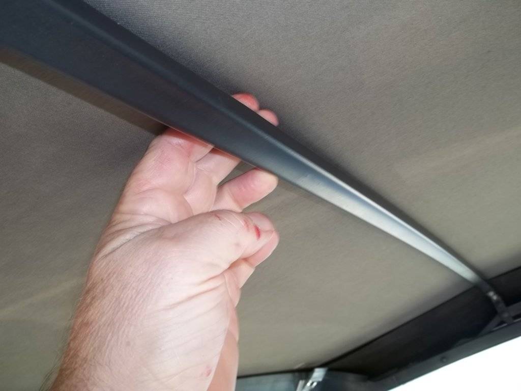

I would agree that you are probably missing the Velcro tab that holds it in place, that’s what’s on mine. I believe the original may have had a stitched in tab. Do you have a pad running front to back on both sides. They are about 3 or 4 inches wide. The Velcro is attached to them. I will get pics tomorrow.
I do have fabric cloth running from front to back but there is no velcro strips.
I can add them though with some good contact glue.
Look forward to the pictures:thumbsup:

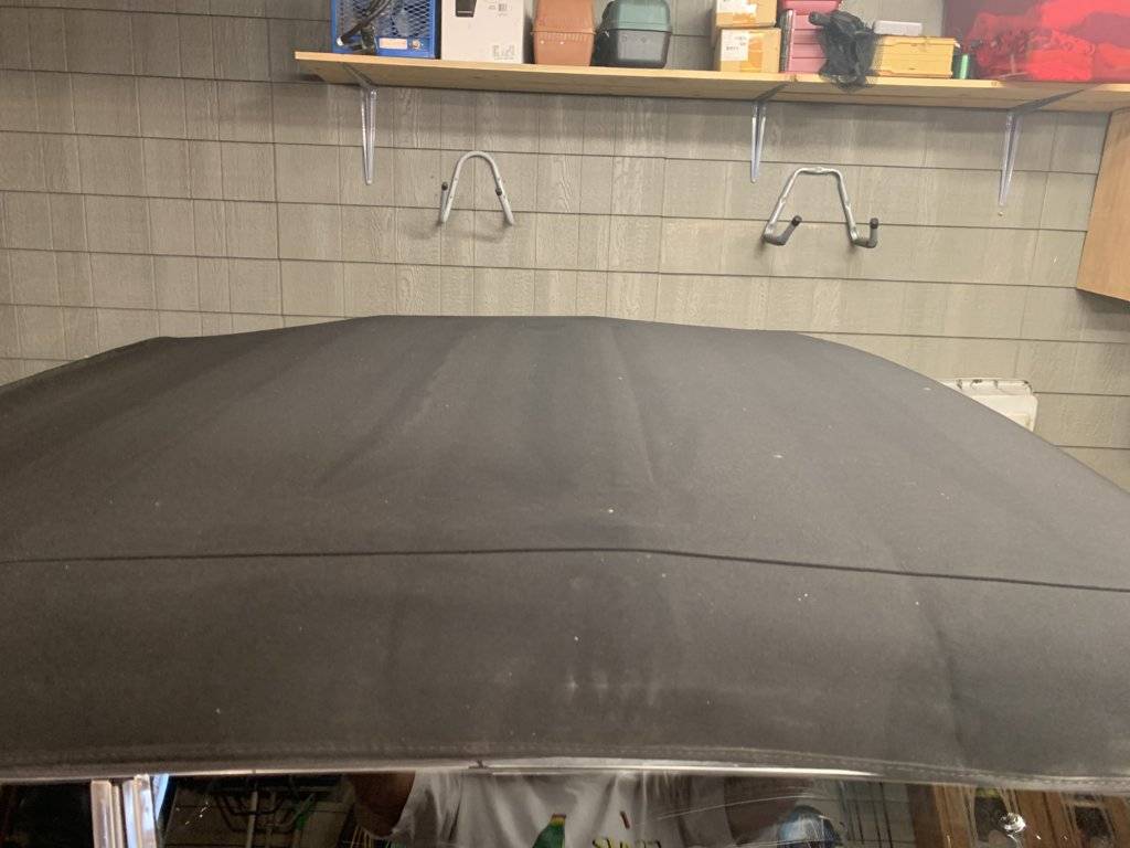

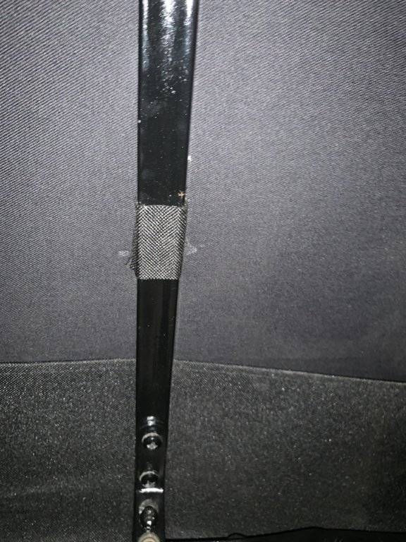

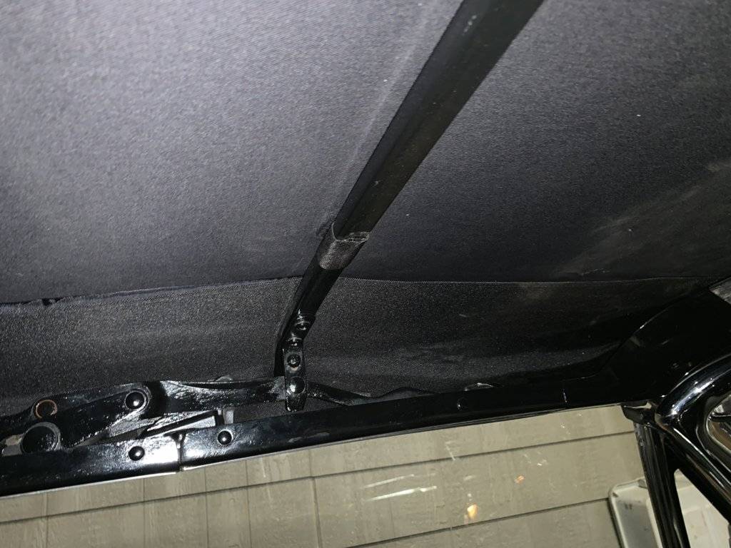

As requested...
^^^ You can see how tight the top is, and yet,
There is no glue, stitching, velcro, zip, nada, holding the top fabric to the bow. But I can tell you the bow does move or shift. It's as tight as can be.

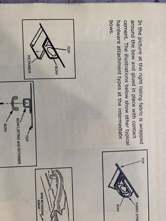

Here are the instructions I got with my top. I glued a strip of material to the bow and then the top to the material. Also attached are a couple of pics. My bow never gives me any issues at all.
As requested...View attachment 305094
this is how mine is but the bow likes to fall back during driving & I have to pop it back into the upright position expecting within 20-30 minutes it will have fallen again.
My bow won't move at all. I got in the car and grabbed it with both hands. I would guess there's an issue where it attaches to the main frame.
