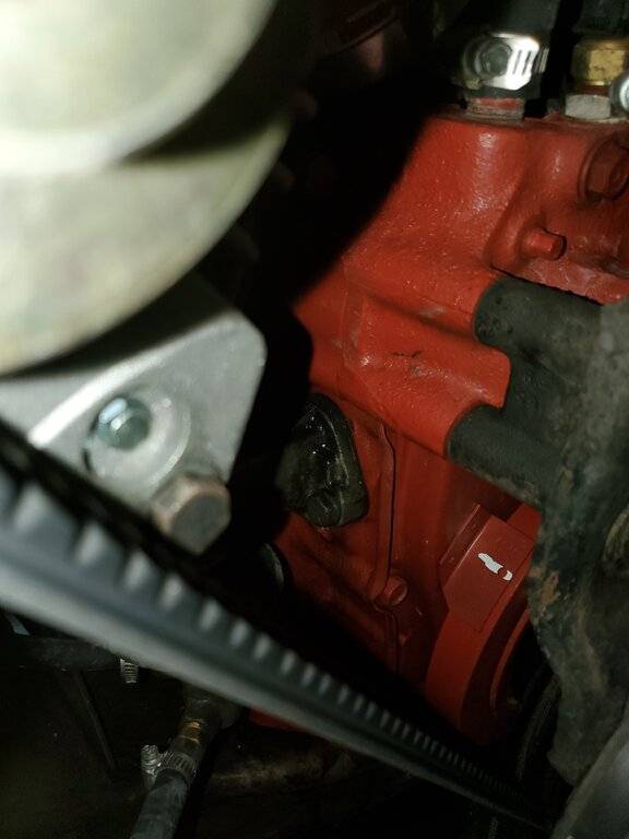

Have a 68 Chrysler Newport. Recently rebuilt 383 bored to a 390. Fitech fuel injection. Heard a pop the other day and am spilling coolant like crazy. It's coming from fuel pump area in the block. Just behind and below the alternator area. Please tell me easily fixable?

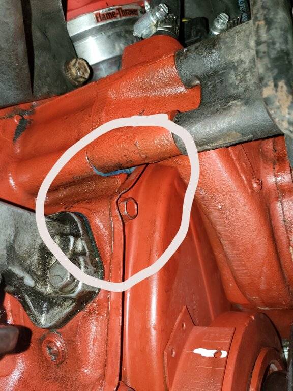

So additional fyi it happened the other day. I got it home just in time but leaked a lot of coolant. I just topped it off without starting the car and it appears to be just flowing from there. I don't see any other place it's coming from. It's dry above and I haven't started the car to get fresh coolant higher up in the system. But its dry above it and only wet right there. Guess maybe it could be one of the bolts that holds the timing cover area in right there next to it?

Can you draw a circle on the photo above, where the coolant seems to be leaking from? Not much there to leak.
Or, take off the alternator, fill it and watch where it comes out.
Timing cover bolts are dry. Just look it over good. Water runs down hill. Put powder on it to see where it’s wet. Water pump housing or freeze plugs on the head are your areas to check.

My guess is one of the exhaust manifold studs. I'm with what 413 suggested, get a bottle of baby powder, squeeze and shake it all over that area and watch where it's wet. Yanking the alternator will help, but a hand mirror & a bright flashlight can work also. It'd be helpful to have a friend with a hose slowly topping off the radiator as you look to see where it's leaking from.

Your heads have a soft plug on each end. I am guessing the right front one gave way. Improper install on the rebuild or if not touched likely rusted through. Take the alternator off and you should see it. Can’t believe an exhaust manifold bolt would leak that much if it is still threaded in. ( unless totally missing.)
Also noticed water pump looks vintage. Could also be your source of the leak.

Water pump is new, just painted. Talked to the guy that rebuilt the engine. He thinks it might be the exhaust manifold bolt. Either way, I'm going to take the alternator off and check the plug at the end of the head and the exhaust bolt. Appreciate the insight. I'll follow up with an update and pictures

Can't leak from that cover, but it sure can leak from the water pump housing gasket on the same circle.
In fact, the gasket looks "funny" to me.
Looks like a gob of blue RTV more than any gasket there. He heard a pop. Maybe it blew out there.
