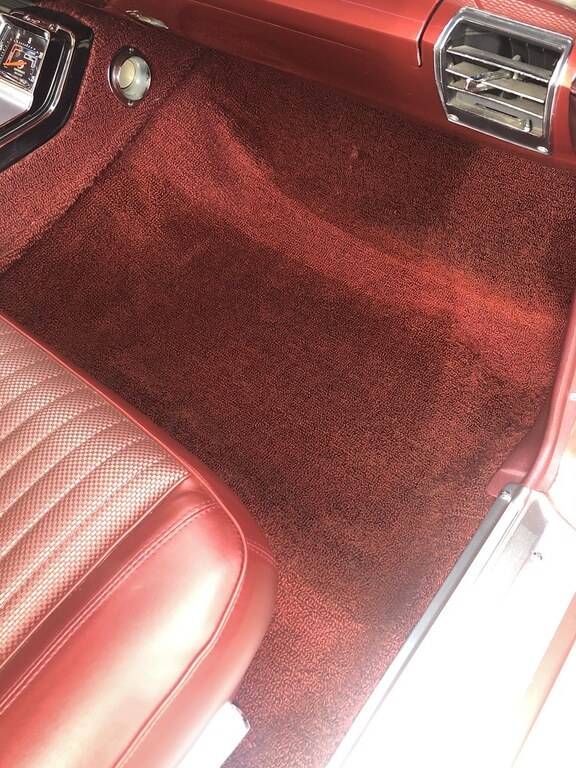

I am having a similar problem in my '65 Chrysler 300 factory AC car.
Found a drip from what looks like inside the vent/box wetting the passenger footwell.
Doesn't look like it's dripping down from above (from a connection outside the box) and feels damp inside those lower footwell heat vents. And it's dry on the other side of the firewall so doesn't seem like it's a bad connection dripping through from the other side.
Seem's like the heatcore has given up the ghost??

Most likely the heater core - but there is another possibility albeit much less likely as there are hoses/clamps and o-rings used on several connections inside the heater box from the factory.

Could be, but the whole things has to come out either way, I am assuming.
Just a better option to potentially rebuild it if thats the case (fingers crossed) vs full replacement.

I have changed the heater core without removing the whole box but I do not recommend doing it that way unless you're a true dyed-in-the-wool masochist.
