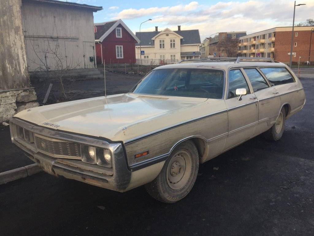

The car appears to have been in various states in all the pictures I could gather online, starting in 2016, along with a periodical control note from 2011 stating that the horn was defective, still is to this day.
Have a little gander, the interior one fascinates me, with the radio and trans tunnel storage removed today, notice the crooked parking brake pedal, which broke the week after I got it, and had to be welded back. It is straight now thankfully.

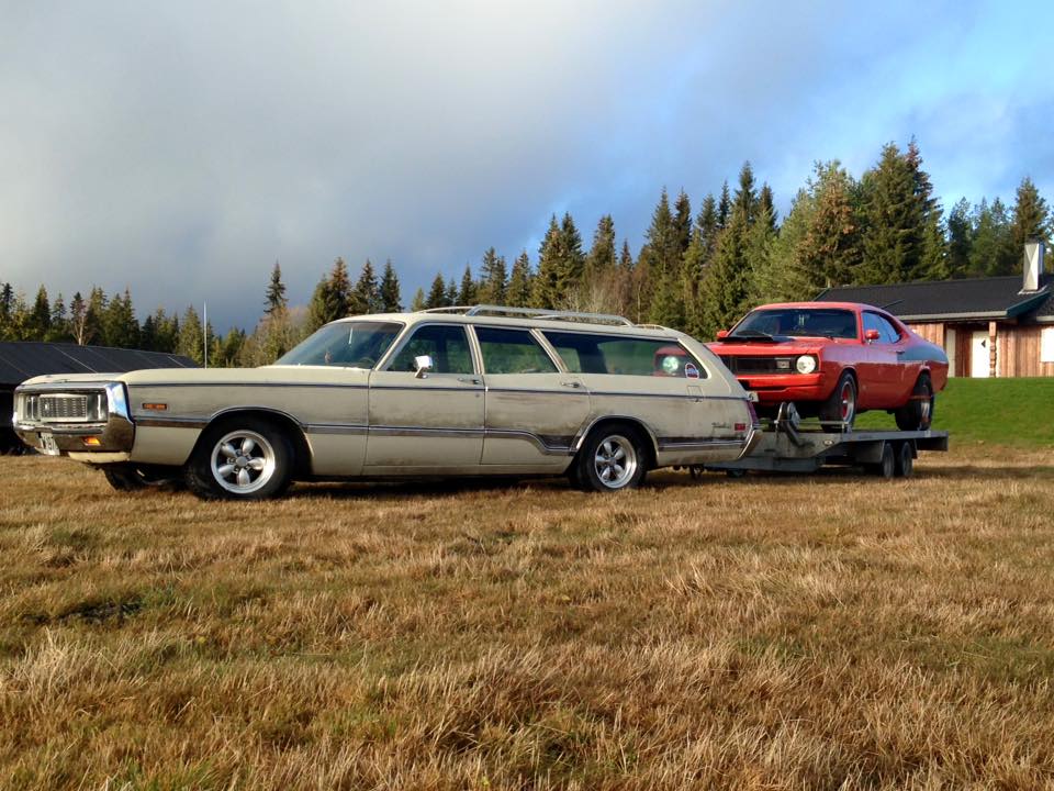

I bought this car a year ago, after staying in the US for a while through work and coming home for 2 weeks, becoming the 5th owner here in Norway and probably at least the 9th owner in total.
I picked it up in midwestern Norway, having to cross a few mountains to get there, my Tesla with fresh winter tires did not appreciate this, and I therefore decided to take my rear wheel drive wagon on summer tires home the long southern route, through windy narrow roads. There I discovered that the suspension is worn, with the car feeling like it was on ice everytime I exited a turn and the rear end just kept going. It did make it the 500 miles home, with the only mishap being that it jumped out of drive on the highway once. However, just before I got home, a valve started ticking just to help me sleep that night.
After I got home Changed the oil (Did not seem to have been changed for a while), made exhaust mounts since they were non-existent and gave it some TLC before I had to take it into storage as I went to sea for a while.

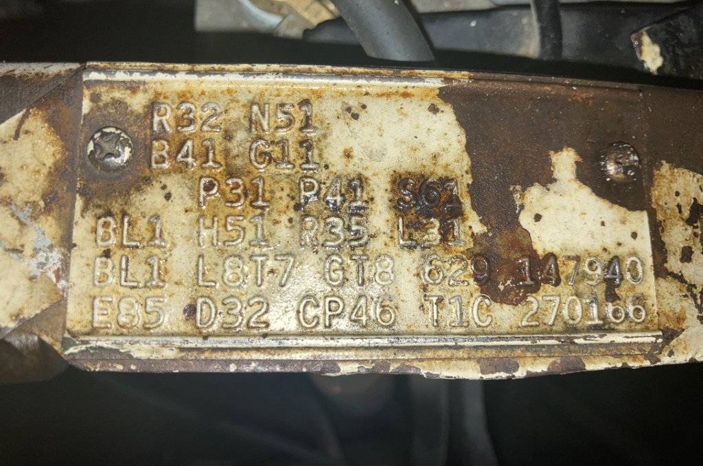

I pulled the build sheet (What was left of it, quite torn on the back of the rear seat, will look for another one) and have done some decoding.
It appears to have the towing package, and is certainly rated for it in the registration, but it does not appear on the fender tag, and the build sheet is missing the group codes.
Here is the Broadcast sheet and Fender tag for those interested:
Decoded Build sheet (some codes are missing/wrong as the build sheet is incomplete and I am also no decoding wizard)

Vehicle Build Sequence - D17625
D = printer station D. Given the spring marks, this probably indicates a station within the interior trim deparment.
The Jefferson plant used the consecutive sheet format meaning this is the 17625th BS/sheet associated with a car printed. It it administrative in function and not be related to actual production.
However, it does give you a relative position of construction. Meaning this car was probably built after D17522 but before D17756. So there is that. This format means the sequence number typically trails the VIN by ~100,000 units. Other plants used the same format or a different format to number broadcast sheets.
U58 tires = L84x15 WSW
Thank you for the insight! Would this mean that if I found another sheet, in the engine compartment for example, it would have a different printer station and sequence number? Or would they just print several sheets at the same time?
Also I appreciate the tire code:thumbsup:

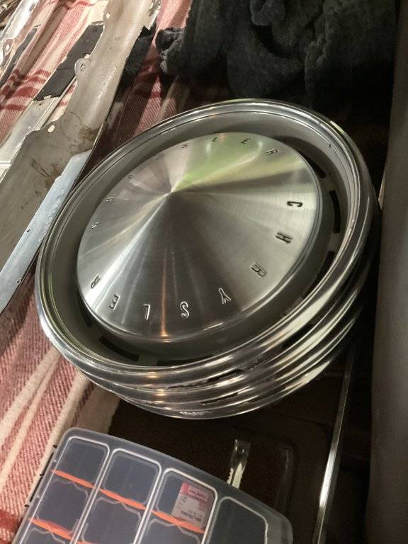

On a related note:
Would the deluxe wheel covers fit on a standard 5.5 15" steel wheel? like this one:
It would likely have another print station but I do not know if two sheets from the Jefferson plant share the same number as I don't have examples on hand.
Yes, those caps would fit those new wheels, but real Mopar wheels that take holy "Police" poverty "dog dish hub caps might be a lot sportier, on the cheap, than the full wheels covers, which are amazing in their simplicity, also insanely clean if they're all that nice.

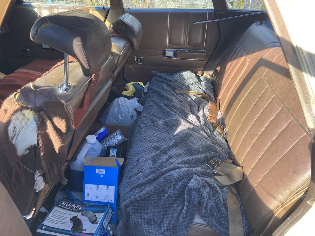

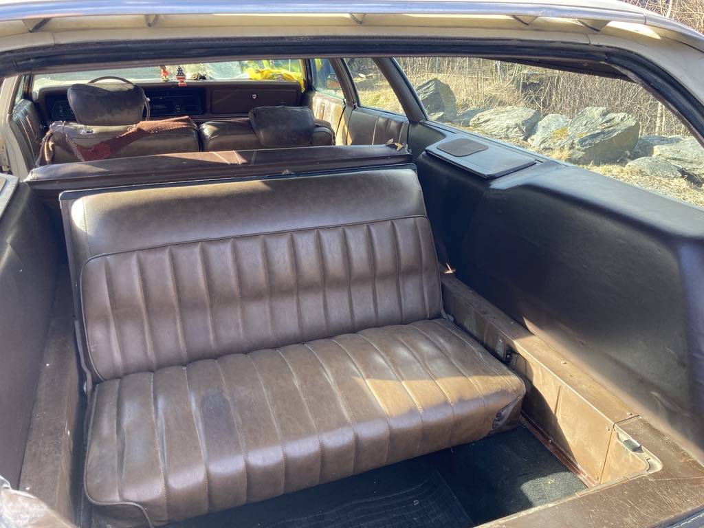

Most of the interior is pretty worn, the front and rear seats need to be redone, the wayback seats are okay, but have been cheaply fixed at some point. The cargo carpet and floor carpet need to be replaced, I’d also like some cloth floor mats instead of the rubber ones, which are pretty ineffective in the drivers well.
I have not yet decided how I’d like the seats redone, I would like some quality material which feels and ages better than vinyl, ideas are welcome.
Also, the door and tailgate are pretty poor / nonexistent. Too bad there are no real replacements. The tailgate window seal and driver door rubber are the most dire.
