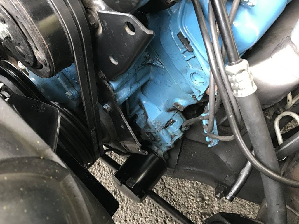

That is a Federal Pump, unless it is shot, do not replace it. If your are getting abnormal performance or noise from the pump, try flushing the fluid first, I does degrade over time.
Dave
Dave
It appears to be leaking badly.
