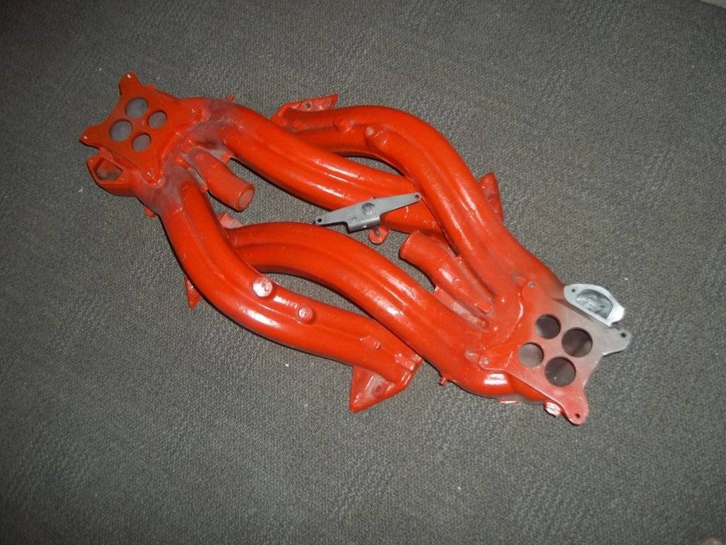

I have scored a long ram sonic cross ram set up for the 413 at the Charlotte Auto Fair this weekend. I am wanting to install these on my '61 Newport that I'm slowly messing with. Is the throttle linkage available anywhere as a reproduction. I only got the two tubes themselves, and am going to start piecing together the rest of the parts to try and get it installed on my '59 Imperial 413 that I have salted away for my car.
I am going to need the balance tubes etc. if anyone know where I can find them. I am not in search of the special exhaust manifolds that are necessary to warm the carbs up with as I will engineer something else as I am going to run headers on the car. I have the AFB off of the '59 Imp motor and hope that I can use it as one of the two carbs. I'm going to start the learning process to see if that carb can be used as one of the two. I'll need to search out another one of those also. No rush on my part. Got more time than money to figure this all out. I've always admired that set up and wanted to have that on a car. It's on my bucket list anyway. I hope I can pull it off and make it happen.
Any education from the populace on here, I would be humbly grateful for.

Congratulations Robndi43 on scoring a pair of crossram castings. You have found the cheapest and easiest-to-find part of a crossram system. (pardon my sarcasm, but I have a pair of castings also so I'm in the same boat as you)
As you are not looking for accurate appearance (I'm not either) you probably have some options on some of the parts. (like aircleaners, balance tube, carbs, carb heating, linkage, and fuel liners)
One thing that you should give some thought to IMHO is some support at the carb ends. I could be wrong about this, but I believe the exh-heated tubes for them add some necessary support. But they will expand with heat, and some rams are water-heated, so I dunno for sure. I just see an awful lot of cantilevered weight being held by only 4 bolts into the head.
Review the chrysler300club.com website for some more info.
There are a few crossram articles in here - read them! Especially find the note about the special cam timing gear for crossram cars, cam timing is a fundamental part of the crossram's resonance effect.

Both are referred as crossrams, and the ones we're discussing in this thread were released first, so technically the maxwedge version is the one to confuse things.
The Sono style are the exact same things as used on the Chrysler 300 Letters, but were named differently when put on Plymouths.
They came in short and long versions, so sometimes referred to as shortrams or longrams, or just crossrams.
O.K. guyz, Here'z the low down. Dual quads on the Max Wedge carz were staggered front on the drivers side and back on the passenger side but NOT acrossed the engine like cross rams and that Intake Manifold(Which 1st came out predating the 426 Hemi by a couple yearz in '62) and haz alwayz in the speed cicrlez been referred to az the RAT ROASTER Intake. The Long Rams first came out in the 1960 300F and the 1961 300G and a few others and in the Dodge and Plymouth lines, ie Sonic Rams. In 1962 Mother Mopar went back to the dual quad "north+south" configuration and a few, 'bout 6-7 sets of the short rams that were water heated and all were used in flat out speed applications. Andy Granatelli had one of the '62s on the salt that year with the water heated short rams. The short Rams came standard on ALL of the 1963 300Js and only SOME of the 1964 production 300 Ks. The Long-Short thing iz somewhat of a misnomer in that ALL 4 YEARS OF INSTALLATION ON THOSE LETTER CARS "ALL" those rams were the same length EXTERNALLY. The difference was in the length of the inner passages of the runners. and you'd have to see both sets side by side to see the external difference in the Long Rams as apposed to the Short Rams. The differences in the length of the internal runners changed the torq range which made the F + G better off the line and the J + K better on the top end and all topped out at somewhere over 100+++, Nap time, Jer
Agreed, all that and more is listed on the Tech link I posted above.
The maxwedge version has much shorter runners than the overhanging Chrysler pieces, and the ports are sized to maxwedge heads, Chrysler rams are sized to the standard port.
But wasn't the Rat Roaster an aftermarket version, that came with removable tops and different carb configurations?
These Son-O-Rams are NOT Cross Rams. A Cross Ram (think Max Wedge) is an entirely different animal.
I've followed these cars my whole life and I, and everyone else I know that loves these cars, calls them crossrams. Be that as it may, for the purposes discussed in this thread, and the fact that the information being sought out, was mostly the information I was looking for. I was not looking for what exact name it is called, or an expert on nomenclature, but thanks for your input.
