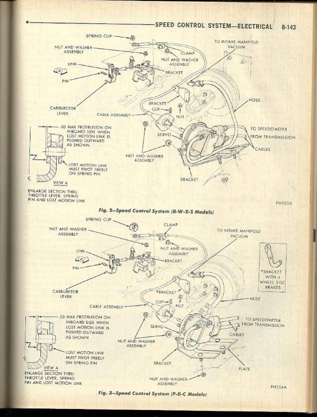

You probably need the lost motion link. In the attached 1976 Service Manual scan, it's the part called "link".
Hope this helps.
Pat
Thanks! That was what I was looking for! I do have the "link" and the roll pin. I just could not figure out how it was installed. I have a 1968 and 1969 factory service manuals but the picture or schematic was not clear on where or how this link was installed. Now I go a project for this evening!

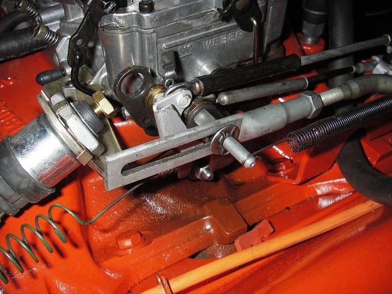

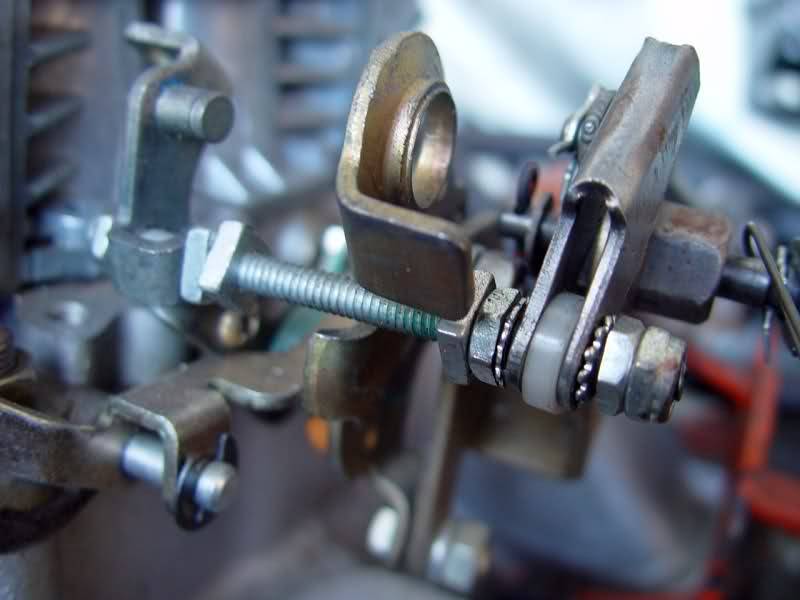

Edelbrock (nor Holley as in my example) doesn't make a provision for the link.
I had to modify the throttle assembly a tad to accept the old link and CC cable
Maybe this will help a little:
If you can, post pics of your setup when you're done so we can check it out.

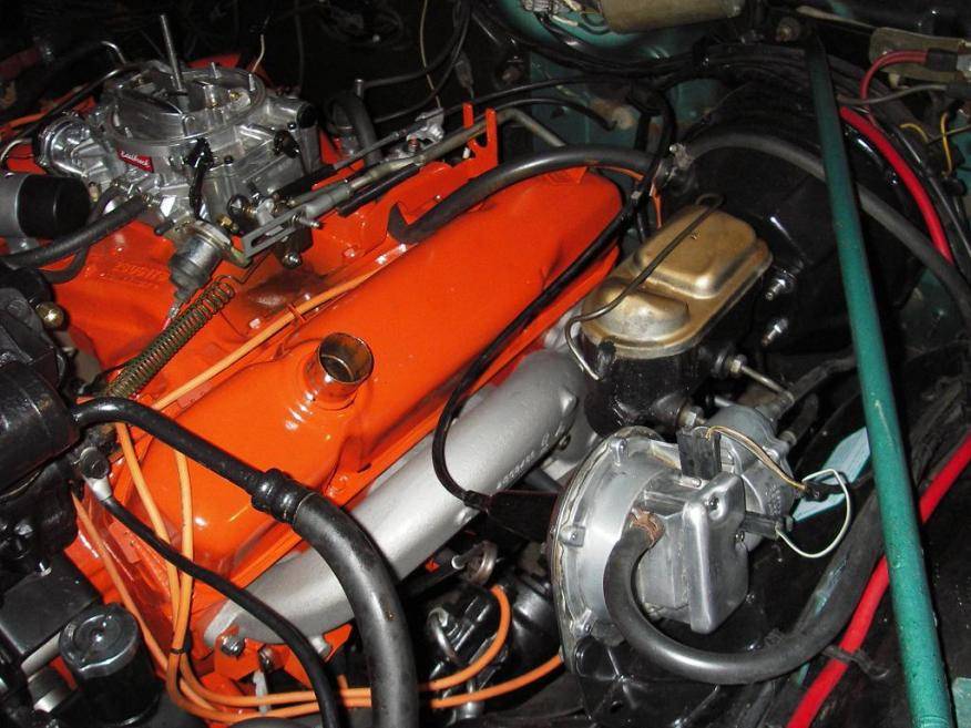

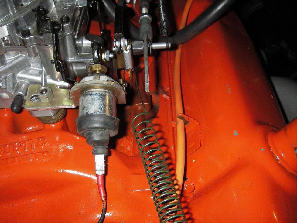

I got my cruise control installed!
I got my cruise control installed yesterday! With the scanned shop manual page and the pic's, installation was a snap! I found on the Edelbrock Chrysler linkage adaptor that the proper hole was already there! I was using that hole for the return spring! I tried it in the garage with the back wheels off of the ground. It surged real strange like! I guessed this was because there was no load on the motor! On the street it worked flawlessly!
Cool! Glad it worked. Thanks for posting the pics! Keep us posted on how it works long term.
