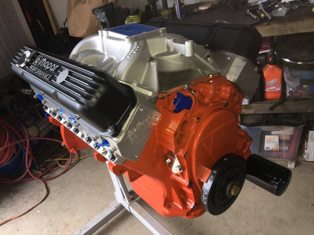

I need a harmonic balancer/damper/dampener/whatever you want to call it for my 383, rebuilt to stock specs from the two second conversation I had with the seller. Any recommendations as what to buy what to stay away from? Ai know there's Fluidamper amongst others, don't know what is better, or overkill. The engine is just going to be a driver, a few blasts up to the century mark, but mostly just cruising around. I be using stock style exhaust, and I believe the car has highway gearing. Thanks folks.

No, I can get one off a parts car I have, but thought it better to get a new one for the rebuilt engine vs using a 52 year old one.
