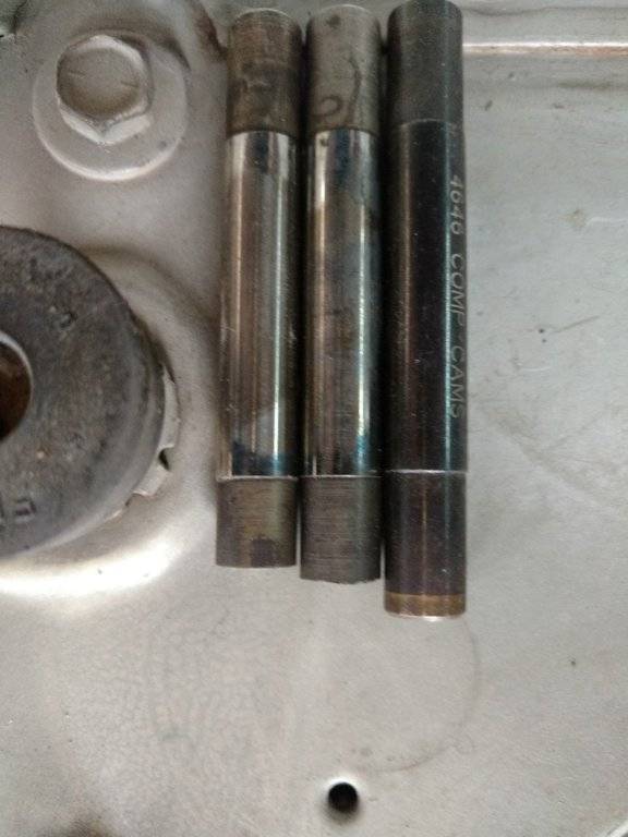

Why is my Imp eating fuel pump pushrods??:BangHead:
The one on the left is from a few years back(some of you should remember that one), the middle one I just removed and the one on the right is the new one that stays in the car in case I’m on a road trip and need one.
it all started with low to no zinc in the oil . just like a solid lifter , they chew on each other . i've got through many mech pumps to find myself using an electric pump to fix the problem nore than once on 440's , now my 383's have not had is issue , its the same parts . go figger , lol .
Drive lobe is bad. Probably got scored up from the first dead push rod.

I’ve ran Brad Penn since the new top end.
I think the first one got worn down by the original cam. I put a new cam in it and then discovered the warn pushrod. I don’t know how long I ran it with the first pushrod on the new cam though....

Usually a simple way to check the condition of the drive lobe is to pull the pump push rod and stick a bore scope in the casting that holds the rod to take a look at the cam. Probably going to find it shot and time for an electric pump.

Were those the Comp Cam rods?
I replaced my Mopar one with the Comp Cam one last September (maybe 1500 miles on new engine)
A couple weeks ago I inspected the replacement and it was not worn, a little shiny but not worn. This was after another 1500 miles.

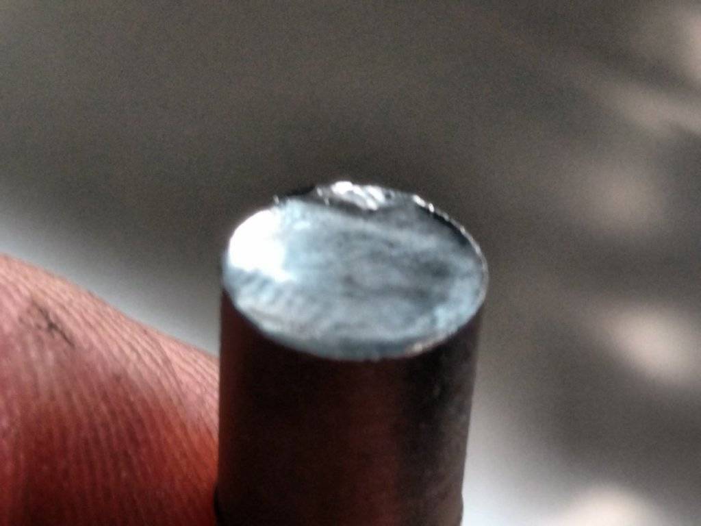

First one with temporary new one.
Replacement Comp Cam one after another 1500 miles

I think the first two were old OEM and I have one more of those and pick up the new comp cams one the last time I was at Mancini‘s just to have another extra.
