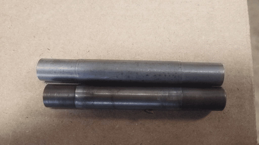

It's become a common failure point. Once the pushrod starts to wear, it wears very fast as it goes from the case hardened outside to the non hardened inside. (think Tootsie Roll Pop).
You won't find the length in the FSM. It should measure 3.220" in length.
You have to pull the pump and then the allen headed plug to remove.
Typical wear, pic stolen from a @Toolmanmike post.
