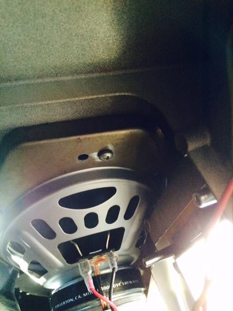

Dash speaker size? '65/'66 Chrysler

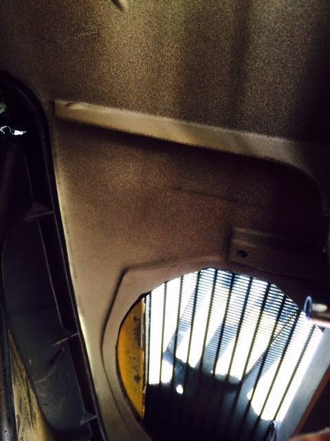

Looking from below, I didn't see any clips for the metal speaker grill. It almost appears that the grill is a permanent part of the dash pad steel base and foam.
It's also interesting to note that the opening for the grille is smaller than the speaker shape.

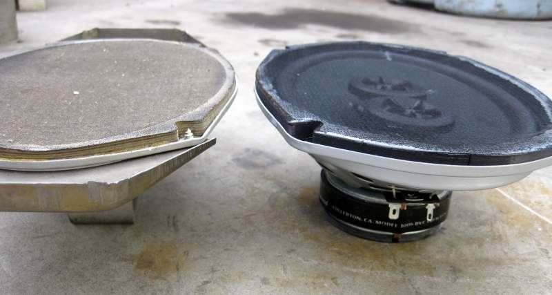

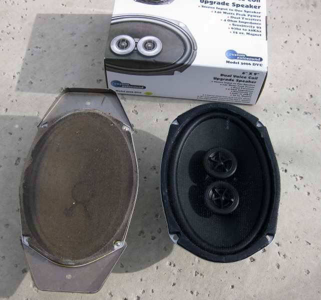

The 6x9 Custom Autosound dual voice coil speaker I bought fit, but not without modification. You can see they are roughly the same size and depth:
However the size of the magnet is much larger on the replacement speaker. Consequently it was bumping against the face of the dashboard (just above the glovebox and clock).
The magnet is up against the dash at the right side of the photo above. You can see how I adjusted it a bit by drilling new mounting holes to shift it further forward under the dash. There was enough room to move it sufficiently without hitting the defroster duct.
Besides that adjustment, I'm pleased. The converted radio sounds great and having features like Bluetooth is gonna spoil me.
