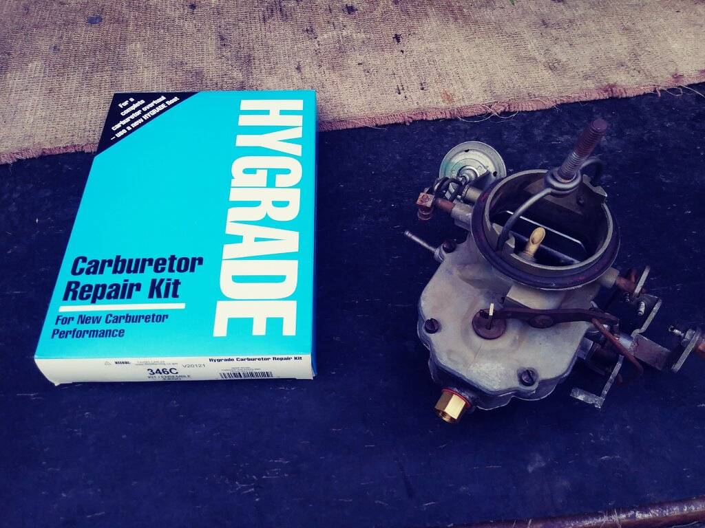

I used for 1970 Fury 318 Carter 2BBL Rebuild: Walker Kit 15284C. It may be simpler to have a rebuild shop in Britain install a shaft bushing and replace the butterfly screw. Then it's a straight rebuild.
I used the Hygrade 346C kit..
well in a moment of boredem I boldly went where many cack handed buffoons had been before me.
Got the carb stripped, cleaned and sitting on the bench,the main damage was the missing screw head of the choke butterfly and a slightly bent butterfly, the remaining screw came out with some fiddling, broken screw with a bit more.
Replacement screws came from my 'gash box' (decades of aircraft engineering it'll be useful one day bits) reprofiled the butterfly, sorted.
Not quite.. I was (am) one of those cack handed buffoons, guilty of putting it back as it came apart and not checking, turns out most of the accelerator pump vent valve is missing. So I'm waiting for another parcel to arrive with yet another rebuild kit, this one with all the bits, so as we are in yet another Lockdown shall I paint the inlet manifold??? No I didn't find the screw head, not too sure I want to go looking.
