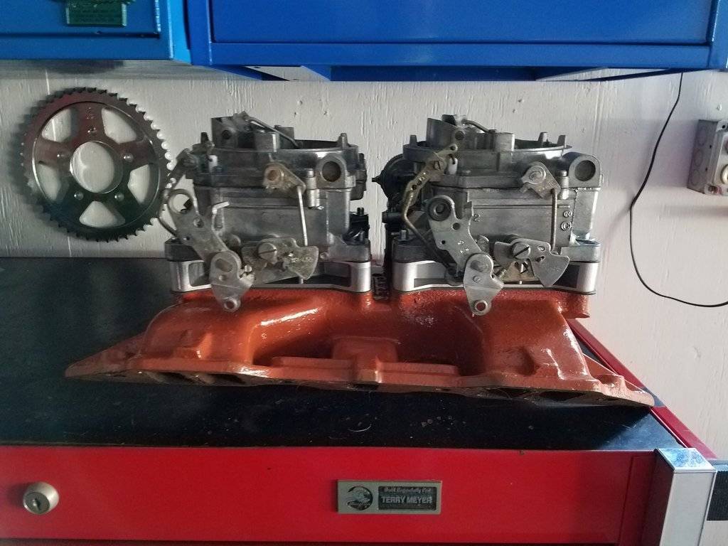

Does anyone have a picture or dealer installation info for the dealer installed 58-59 383 dual quad? I would like to replicate the correct linkage. Unless someone has one laying around that they eould like to part with! Than

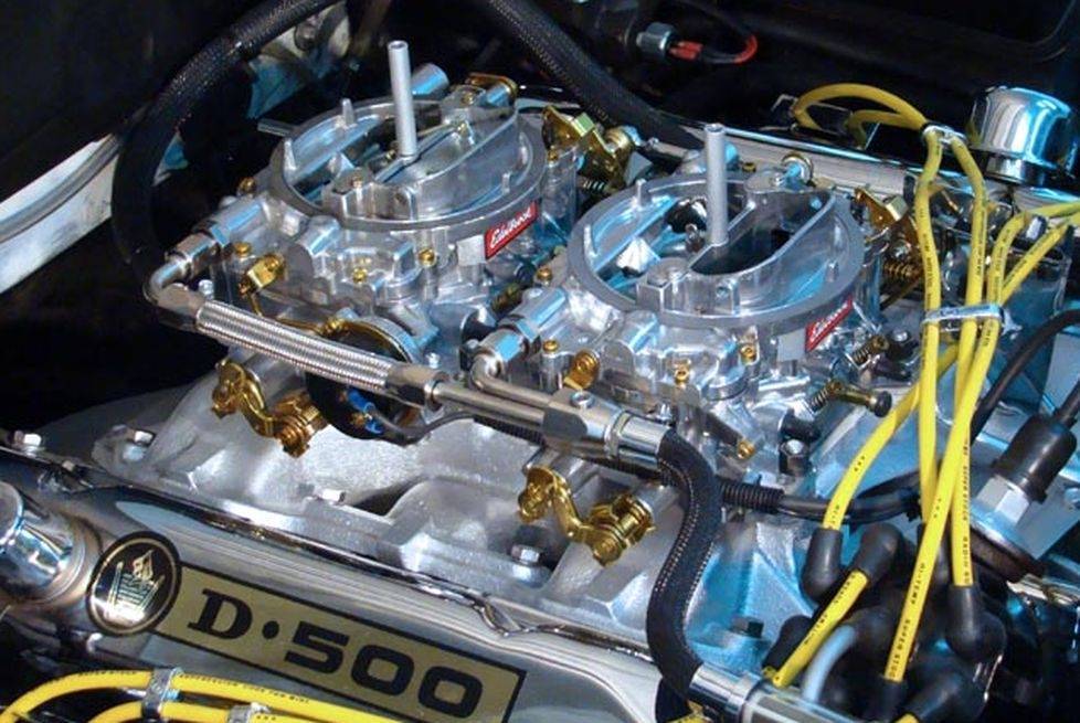

Also, can't forget the Dodge D-500 wedge engines, either.

Does anyone have a picture or dealer installation info for the dealer installed 58-59 383 dual quad? I would like to replicate the correct linkage. Unless someone has one laying around that they eould like to part with! ThanView attachment 137011 ks!!

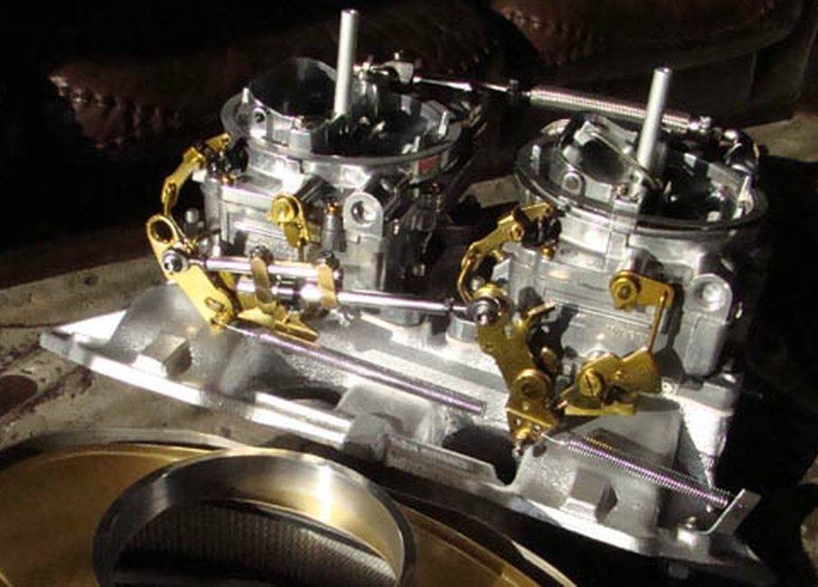

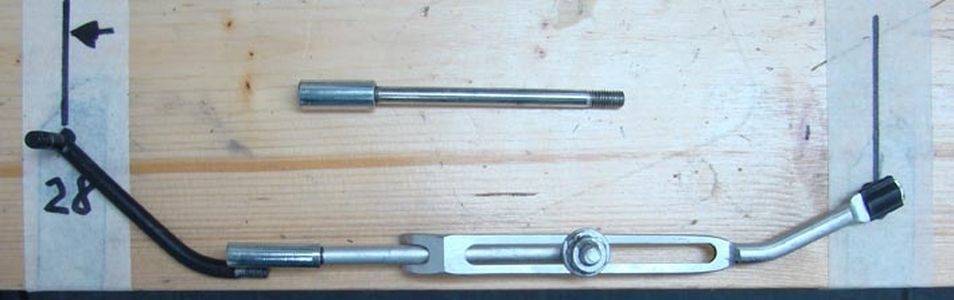

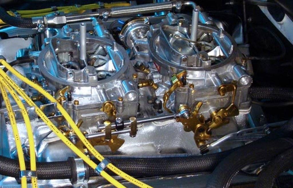

Oh that's a pair of AVS carbs on yours isn't it? The originals would have been AFB's. The linkage won't be the same, here, have a look at this.
