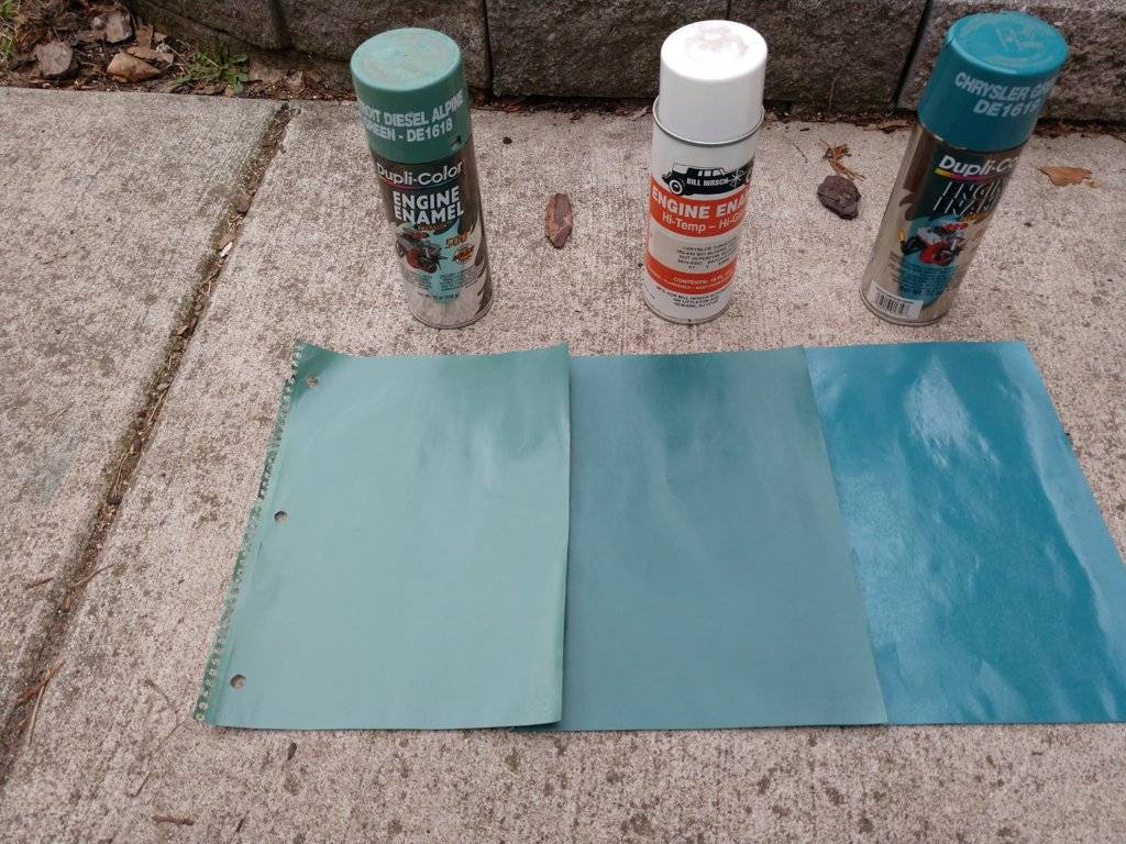

    As for the turquoise engine paint. I think Bill Hersch's product is closest. But keep in mind, after several heat cycles the color will fade and change, just as the original did. Even finding a protected area the color has been effected by heat and age.

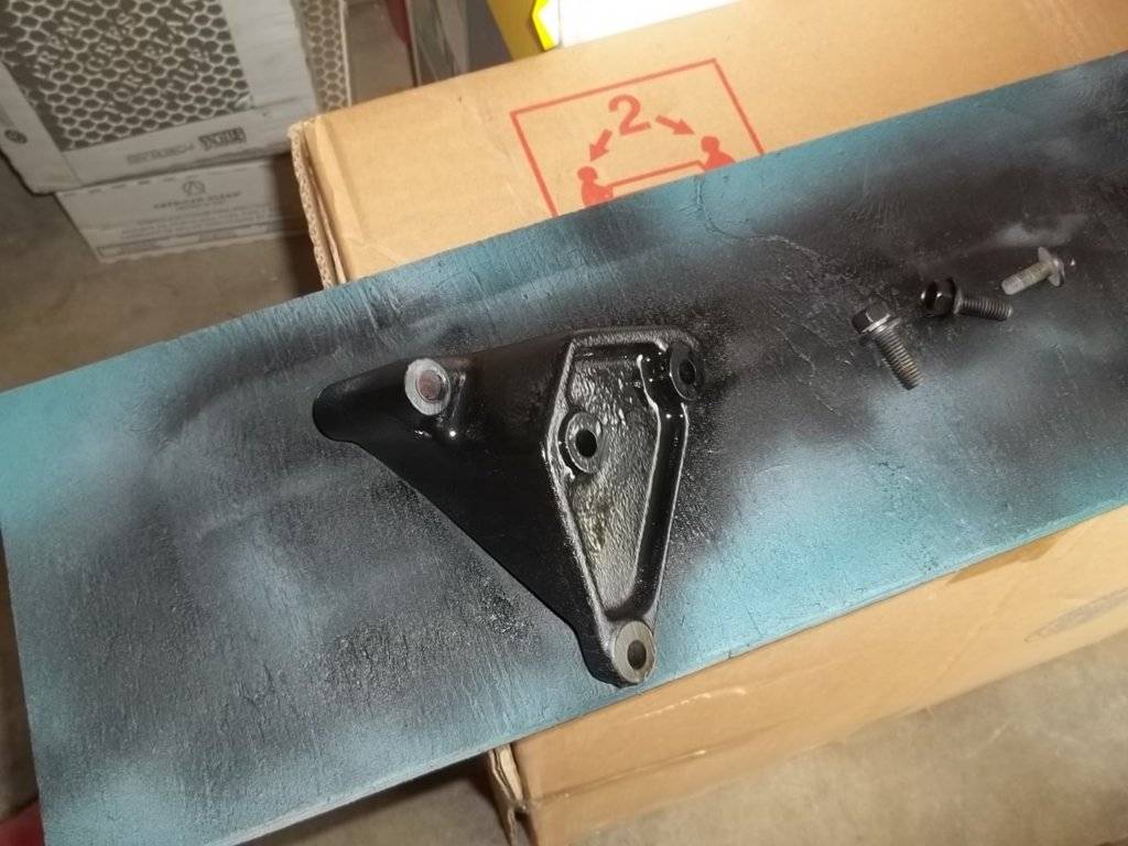

    After dunking for a couple hours in a mixture of de-greaser and water, the mystery bracket revealed the remnants of a black coating. So I shot it with Semi Gloss Ford black. Oil cap 13 .JPG

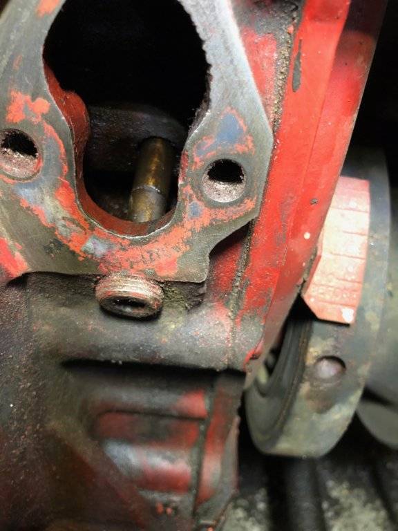

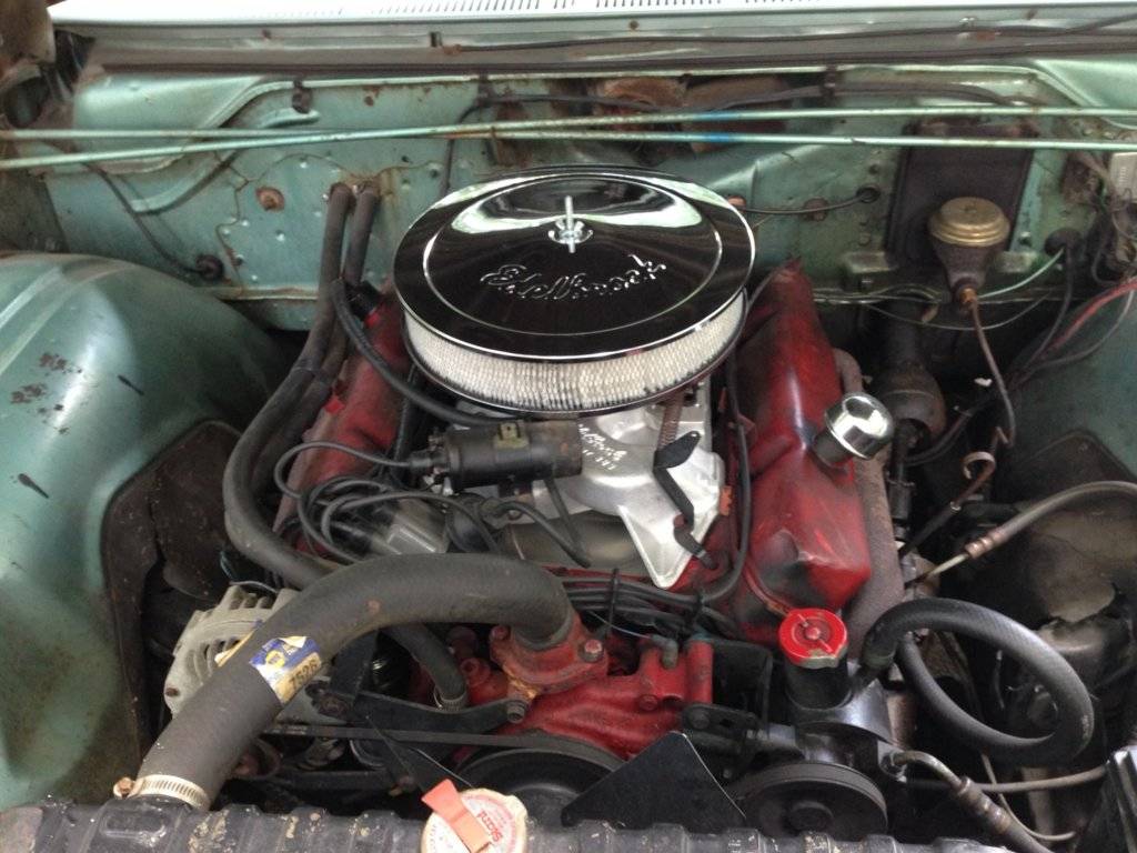

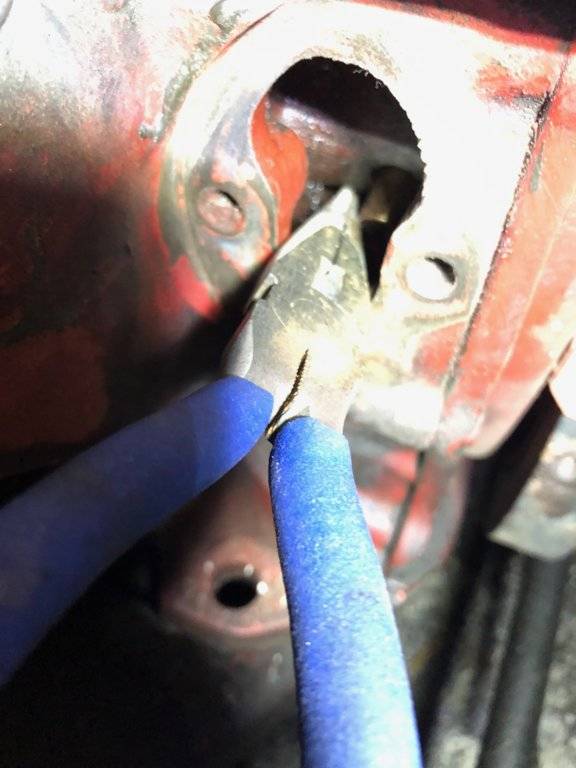

    Thanks to all for the info. The 383 engine is red on my 1966. After reading articles that the standard for Mopar big blocks in 60's was turquoise, I thought mine could have been repainted, but doubted that due to the naturally aged look. Davea Lux comments (1/4/19) explain that red blocks were possible. Then last week when replacing fuel pump, seeing the inside of the block as same color red confirmed it's original paint color. Got Build Record Certificate from FCA four years ago, this car was built in Belvidere, Illinois plant, shipped to dealer in April 1966.

    Never say never. A red 383 that was destined for the Canadian market installed in Belvidere? LOL!
    Who knows..maybe the car was travelling in Canada and had a warranty block replaced??
    Regardless,I would keep your engine red as part of the car's history--and mystery,LOL

    Mab'be the guys in the engine paint shop were hung over cud'int be arsed to switch over the paint cup after a bunch of 318's came down the line. :poke:

    Definitely will cbarge, and that's a plausible explanation, as is
    68PK21 440.6bbl's. The possibilities are endless in a high production factory back then, or thereafter!

    Another plausible explanation is that one plant may be short of engines and another had a glut of engine and shipped them to get used up.
