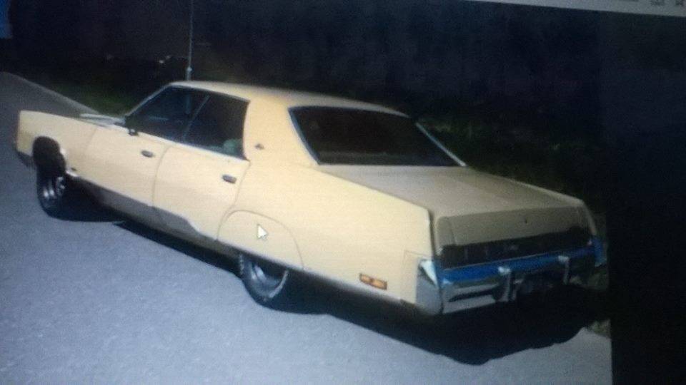

Did they ever make a Formal 4-door hardtop without vinyl roof?
hello, i have a ,74 new yorker 4door hardtop without vinyl roof. I,m not sur if it was originaly that way..
Vinyl roof cars had trim around the bottom of the C-piller that were held in place by clips that required holes all along the bottom edge of the roof.
Unless they were all filled, no holes = no vinyl from the factory.

Is that the best you can do? Come on, show her off.
Look at your fender tag and see if you have a V code on it.
V1W White vinyl top

i can,t find any holes or evidence that they were there before. The car is painted new 10 years ago ,maybe they filled the holes.Sorry at this moment i don,t have more photo,s. Will make some soon.
Is there a V code on the fender tag?

There is a code for no vinyl top. I can't remember what it was. The Mopar codes are always 3 digits. E86 = 440 engine, V1B - Blue vinyl top, etc.
My car has the code for no vinyl. We brought that up in a thread a month or si ago.
It was the code for PAINTED ROOF I think... LA2?
I'm having a flashback...
I'll forget it again in another month.
In two Formals that I have pulled the vinyl off of, the roofs did not have the finish paint.
Cars that got a vinyl roof did not get the roof painted from the factory. Hard to believe, but it cost the factory LESS to put a vinyl roof on a car than it did to paint the roof.
The delete code for a full vinyl roof would be V18. The third digit was for the colour and colours were denoted by a letter. A "9" in the third spot meant a special order vinyl roof, while an "8" meant no vinyl roof.
On the body tag, the first entry on the second row from the bottom is for the lower body colour. The entry right above it was for the roof. Thus if the car was to have a full vinyl roof, a code such as V1X, would be on the tag on the third row. If no vinyl roof was to be installed, the code for the colour of the roof would entered.
Thus the tag with the LA2 on the second row from the bottom shows that car was painted Silver Cloud Metallic on the lower body while the LA2 on the third row of the body shows the roof was to painted Silver Cloud Metallic. And no vinyl roof.

1) You can't delete something that wasn't standard. Unless it was part of a package, a vinyl top was optional. The only V19 code I can ever recall seeing on a fender tag is on Superbirds.
2) Formal cars will code the top (V1, V4 or V5) over the lower body color if a top was ordered. Otherwise, you will see the paint code listed twice if a vinyl top was not ordered.
3) Exceptions may exist for fleet cars like for cop cars. You can see codes like 999 over 999, V02 or V09 depending on how the car was ordered.
