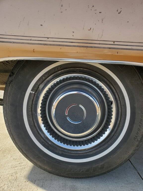

My new to me 69 Chrysler 300 has what looks like the original rear axle, 8 3/4 -489. It's non-suregrip and what I presumed was the standard 2.76.
First pic - chalk mark at 9:00 on tire with a corresponding chalk mark on the bottom of the drive shaft.

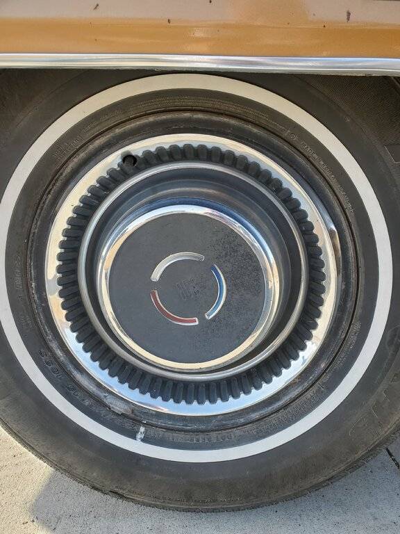

As I rotate the tire and watch the drive shaft (both wheels in the air, car in neutral), when the drive shaft makes one complete revolution the chalk mark on the tire is at 6:30. (Second pic)
One complete revolution of the tire rotates the driveshaft approx 1.5 times.
What am I missing here? Doh!
Thx
You need to make sure only one wheel is turning. You’re wasting some motion through the spider gears driving the other wheel in the opposite direction. That’s my guess!
On an open differential you can have both wheels off the ground, transmission in park and spin the wheels by hand. The driveshaft will not move. If you look at the other wheel it will be rotating in the opposite direction. If the transmission is out of gear, some rotation will randomly go to the other wheel and some to the driveshaft.
