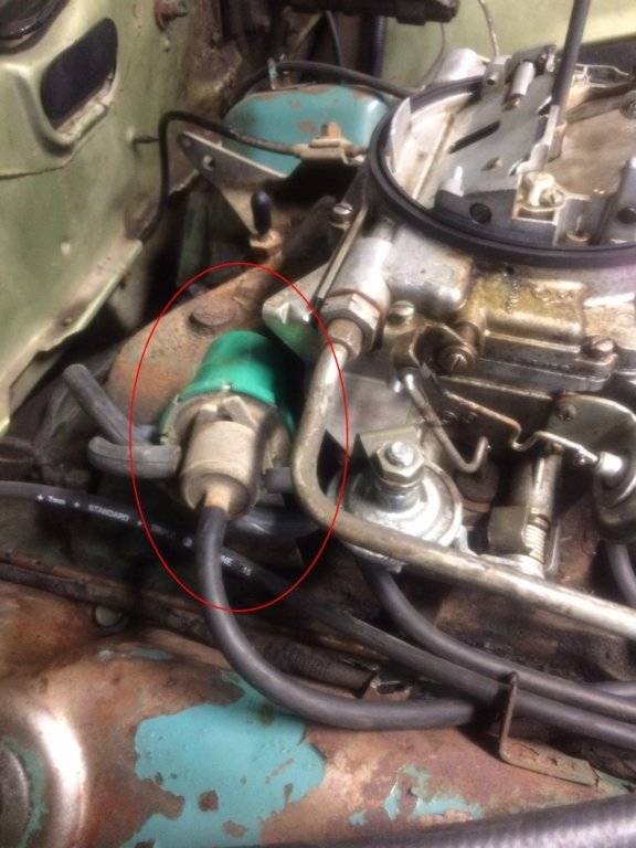

Don't know what you have, but mine had a "Distributor vacuum control valve", I member back when these hit the trash pretty quick. My car ran good when I got it so didn't worry about it. Until recently, was doing some adjustments and what sounded like an exhaust leak was this thing rattling around. Disconnected it and ran even better.

Don't know what you have, but mine had a "Distributor vacuum control valve", I member back when these hit the trash pretty quick. My car ran good when I got it so didn't worry about it. Until recently, was doing some adjustments and what sounded like an exhaust leak was this thing rattling around. Disconnected it and ran even better. View attachment 218628
Looks like some sort of emissions control device from back then? Mainly on CA or CA-spec vehicles? Or on manual trans vehicles?

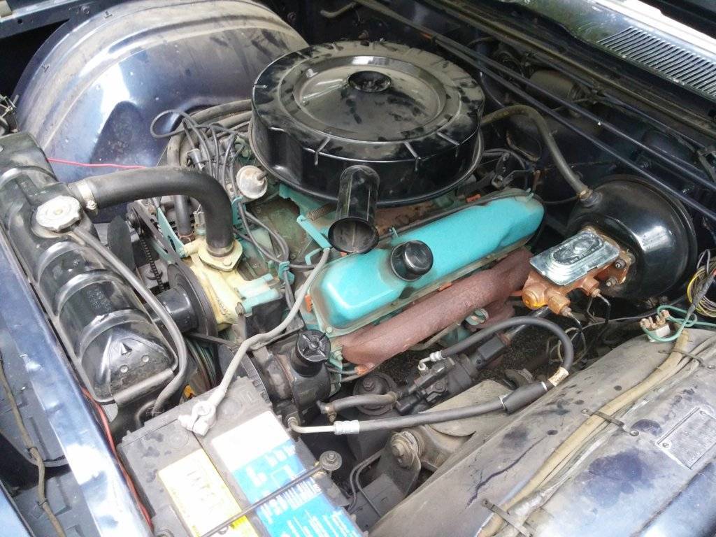

That looks to be part of the Cleaner Air Package, which mine does not have. According to specs they have timing retarded to top dead center to increase the after burning of air pollutants to meet California state emissions.

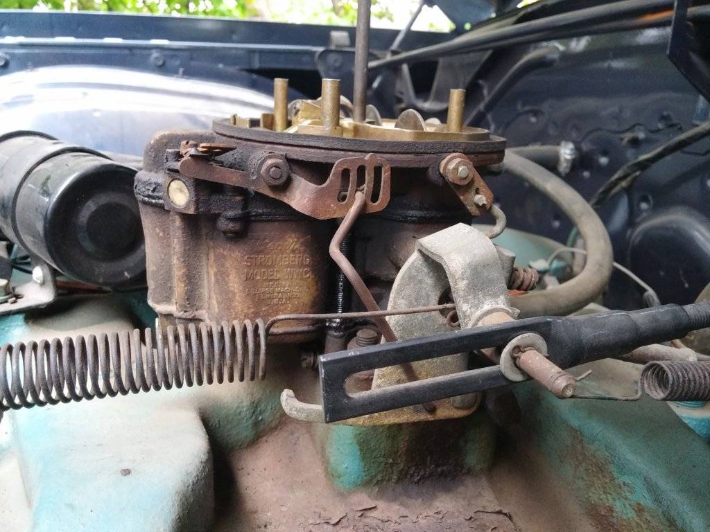

I tried manifold vacuum w the distributor I'm now happily running w a decently rebuilt Stromberg WWC on the proper port. Stick with the ported vacuum friend. CBody 67 helped ME just a couple weeks ago with a pinging issue on MY 66 2 bbl Newport. I finally found a sweet spot in my timing at about 14 degrees BTDC with the new Cardone 843817 I bought when the reman 303817 I had run for a bit over a year was found to have an utterly defective vac advance. I twiddled and diddled a couple months before hitting this spot after a fresh re-read of the FSM. When time and money permit, I would love to rebuild the 30-3817 w a good vac advance IFF I can FIND one for it that doesn't cost more than another new distributor.
I'm running Shell 91 octane now which is about the best pump petrol I can find down here. Mathilda purrs pretty sweetly with it and I have NO PINGS, not even the slightest chatter when accelerating now. Even the kickdown is working smartly. Heed Mr. CBODY67 bro. He'll steer you down the right road.

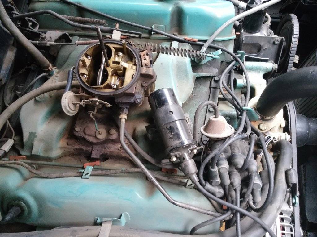

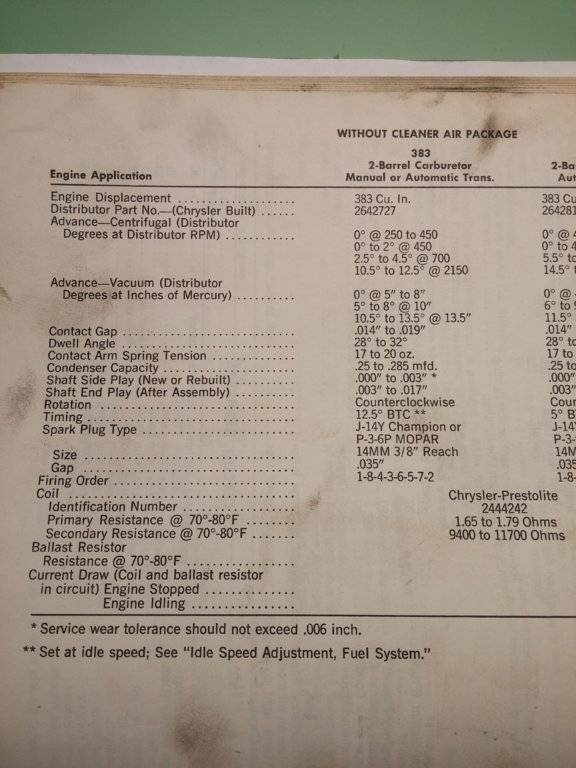

Here's what I got: 383 big block 9.2/1 Compression. 2bbl Stromberg WWC3 carb. Stock iron heads. Stock points distributor (see picture for timing and part number). Stock cam, Stock cast (single dual plane???) intake, Stock cast exhaust manifolds, Single exhaust pipe 1.5" diameter. Also this spring, I had my mechanic replace spark plugs, plug wires, new set of contacts, new coil, new condenser, set the dwell and all that.
From the manual it looks like I was into the mechanical while taking my measurements, oops. Just throwing some numbers here lets say we have 2 engines both set at 12.5* initial like the manual. Both are lightly accelerating up a hill in 3rd. I've got traffic behind me so I've got to speed up. For simplicity's sake lets say the 2 engines start at the same rpm say 2150. According to the manual, 2150rpm would bring mechanical to about 12.5* ontop of initial = 25*. From driving around with the gauge hooked to manifold I know that light acceleration, the vacuum is 10". For ported it might be higher say 15" due to the high load. According to the manual at 10" the vacuum should be around 8* and at 15" it's maxed at 13.5*
The manifold vacuum engine starts at 12.5+12.5+8= 33* but he still has to speed up to get away from traffic. The accelerator is pressed enriching the air fuel mix, manifold vacuum drops to below 5" (from tests), and the timing is retarded from 33 to 12.5+12.5+0= 25* and away he goes preventing detonation as he does.
The ported vacuum engine also starts at 33* but speeding up does nothing except go higher. All the settings are maxed out. "The rich air fuel mix burns faster" or so people say, and coupled with the high degree of timing, ping ping ping all the way home.
My problem with the ported vacuum setup is not only does it ping on hills but it also pings after every gear shift when the engine is suddenly loaded. Also from stop signs.
When you say the initial is set at 12.5 is that BTDC? If it is advanced that can be the whole issue, That distributor is adding almost 60 degrees at the crank if it is working properly.

Sticker in engine compartment.
That's clean too.

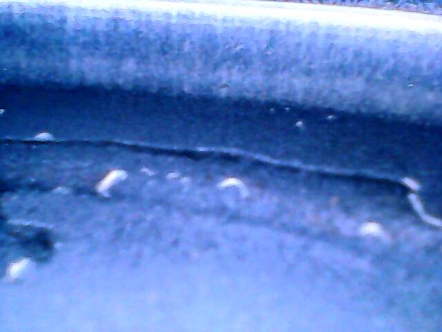

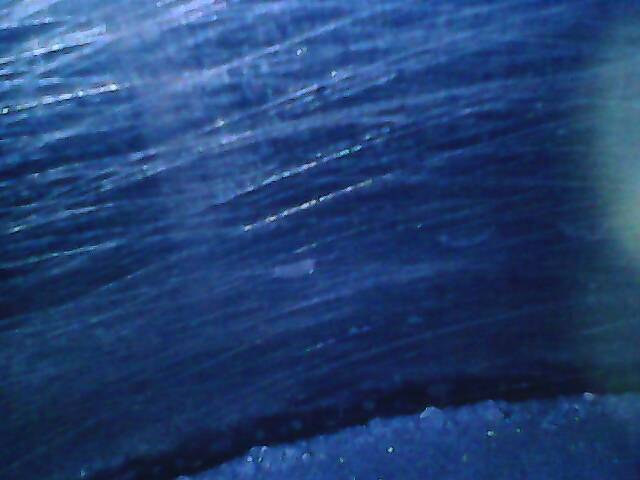

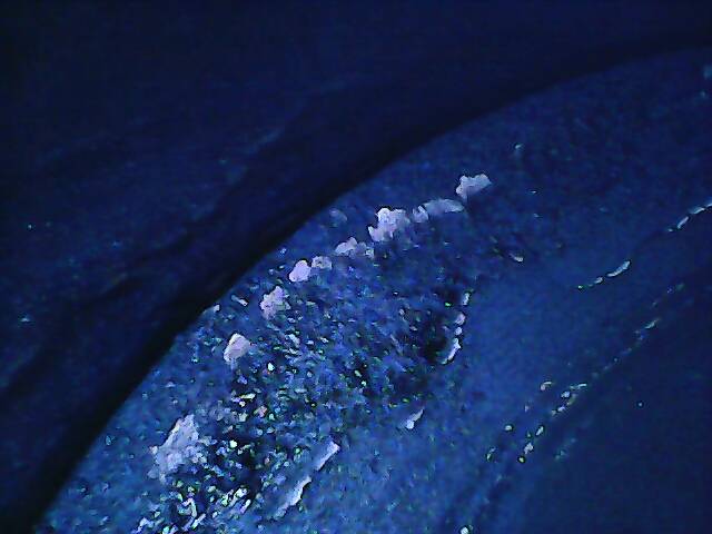

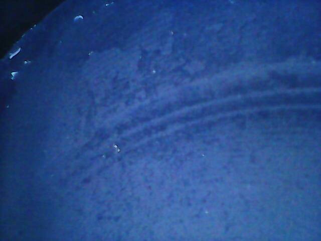

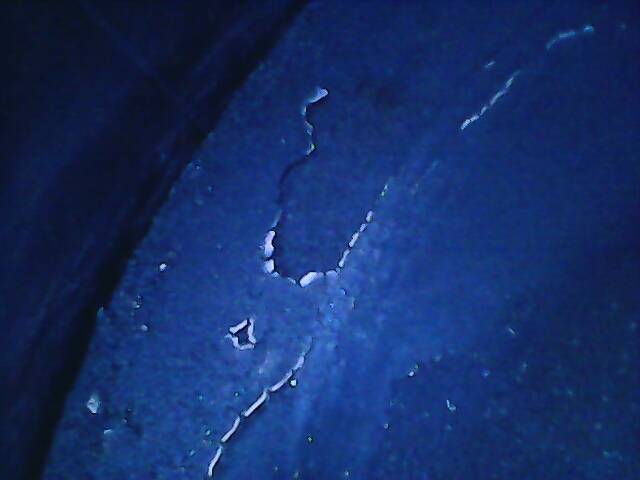

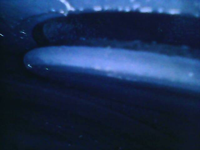

No allen screw in the vacuum canister. Pulled the spark plugs out of the passenger side of engine (2-4-6-8 i think) and checked for carbon buildup on the pistons. Nothing too bad but some is beginning to flake off creating a white edge wherever the heat is highest. Maybe this could be creating hot spots.
Went for a night cruise and about 1 hour in I started having problems. Stopped and pulled & plugged the vac line from the distributor and no problems all the way home.
Plugs were half white (because they're new) and tan colored on the other which would indicate a lean running condition.
Cylinders still have the factory hone. Can see the reflection in all of them.
