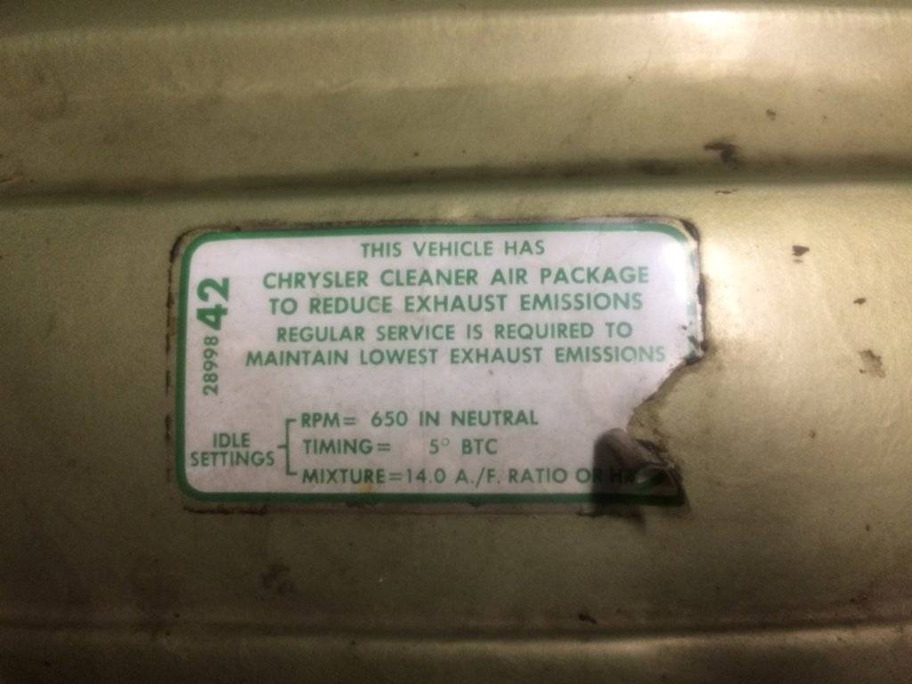

It has the "Chrysler Cleaner air package" car was sold new in Wisconsin so probably not CA emissions. Don't know if it was exclusive to manual trans cars or not.View attachment 219065
That looks like the California Air Package specs from my 1966 FSM. I would love to have the gadget that switched from manifold to ported vacuum w that package; INGENIOUS!! Nice elegant way to use modest tech to lengthen the spark burn. Check it out.
