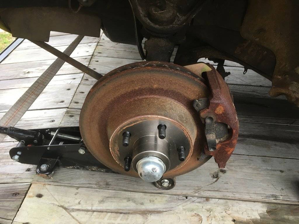

Here's the kit. It's currently installed on a junk 68 Fury I have. Surface rust. Clean up with sandpaper
