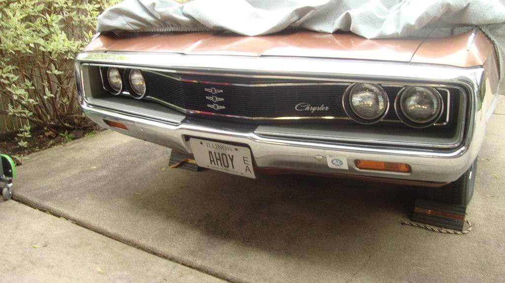

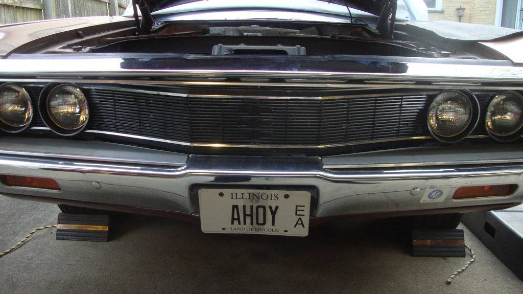

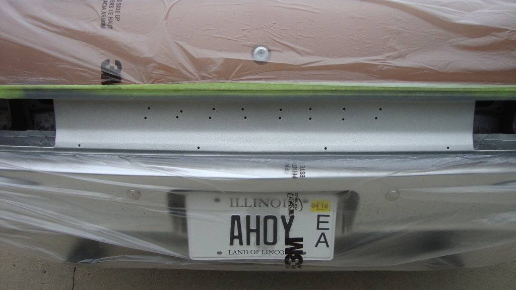

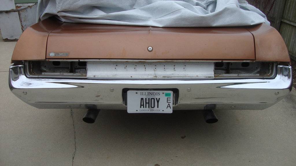

Light Argent. I purchased a few cans from Totally Auto.
Totally Auto Inc. Paints
I restored my grille and tail panel with it and it was a spot-on match. Correct flake and hue.
Also, they have all the correct Mopar colors in stock. The satin black is spot on as well.
before...
after...
tail panel before...
after...
