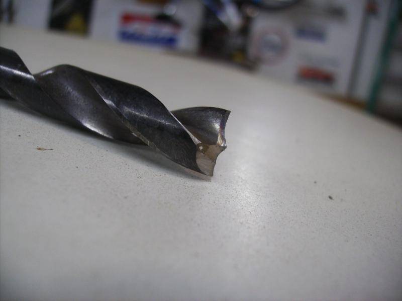

Drill burning up is typically one of two things. Either your RPM is to fast, or the drill is just very cheap low cobalt. Automotive sheet metal is very soft, although the weld may be a bit harder, but there is no reason to go through a lot of drills. Get yourself a good quality cobalt drill, and keep the RPM down. The chips should not be turning colors. A small amount of cutting oil may help also. Here is a pic of the one I made. It's a little rough because my bench grinder is not mounted solid. It's on a pedestal and it vibrates and moves while I grind. The important area is that the pilot is slightly longer than the cutting flutes so that it centers itself and have proper relief so that it cuts rather than rubs.
I used to make those back in my tool & diemaker days. I never got around to making myself a set of them..

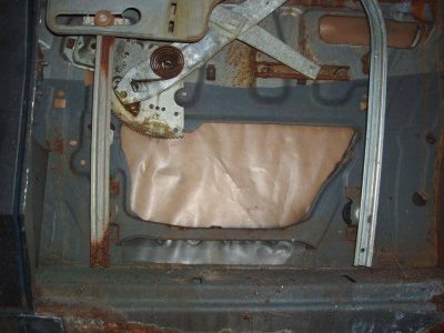

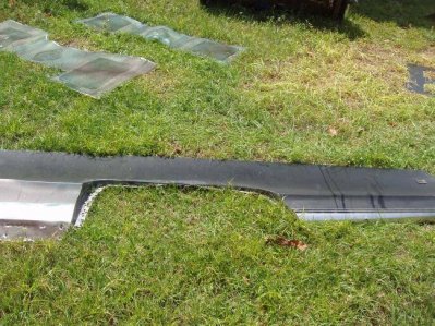

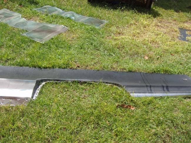

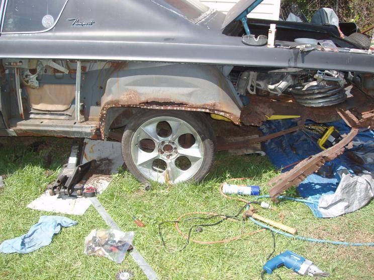

Yeehaw, I got the quarter off. Now what to do. I was going to use the inner wheel housing as well, but it is rusted. I will just cut pieces to fix my car. I'm tired. parts car 045.jpgparts car 046.jpg

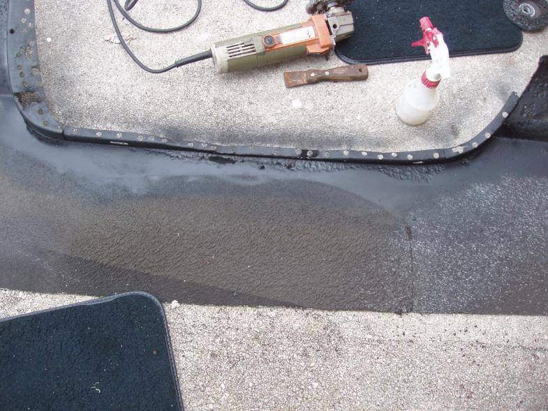

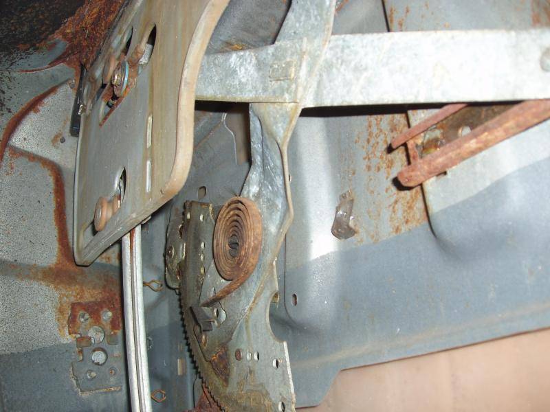

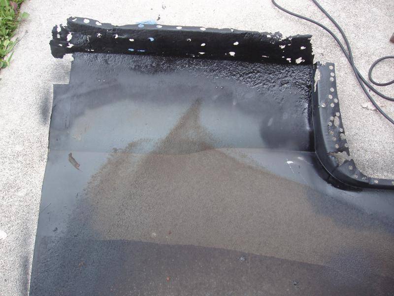

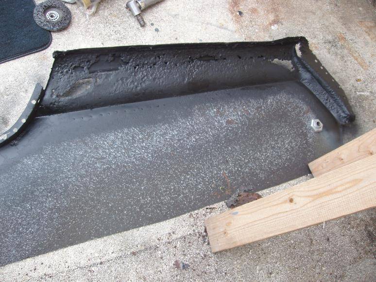

I wire wheeled the rust on the back of the quarter. I sprayed on some rust encapsolator, I will be replacing with good metal, I just wanted to make it stiffer.parts car 049.jpgparts car 050.jpgparts car 051.jpg

Wow,you make it look so easy!Just a few drill holes and wah-la,instant quarter panel.Save as much good sheetmetal as you can,even if it's just to cut up for patching sections.There's a large expanse of good sheetmetal on that roof alone,all in the right gauge to match the rest of the body.Nice job!
