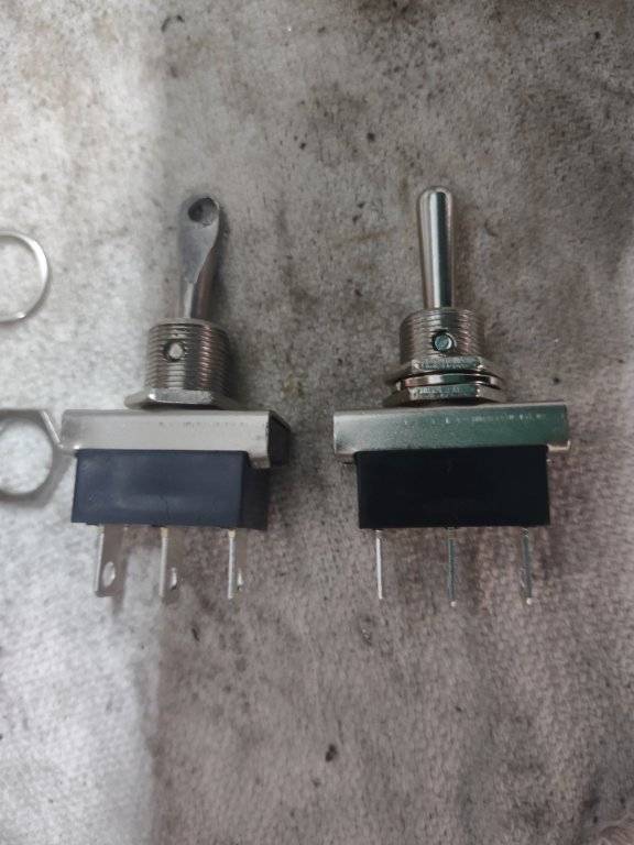

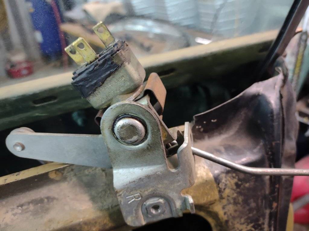

Ive scoured the service and parts manuals for hours with no luck. Looking for the door lock switch that is push rod activated. Only thing i found in the manual was push buttons for imperial. Anyone have a part number or even the name if its not called a switch. Picture included.

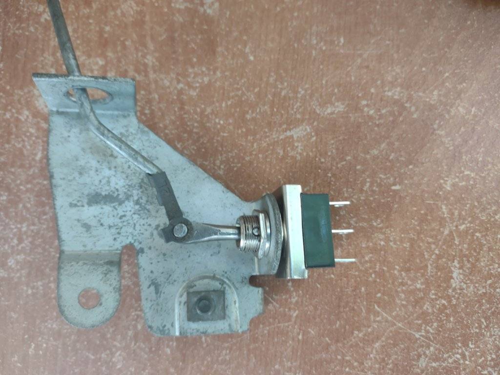

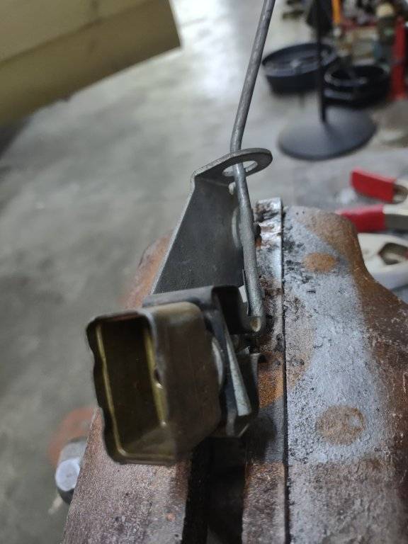

Well pulled apart drivers door and fixed everything EXCEPT, Some previous dufus took the lock switch apart and threw away the parts, darn.

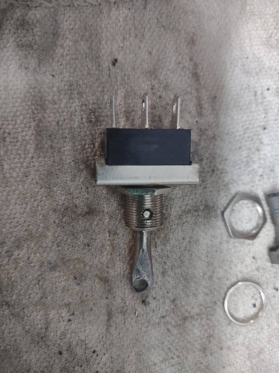

Found a momentary switch on amazon that im going to try and fit to the bracket. Hopefully i can flatten the toggle enough to drill a hole in it.

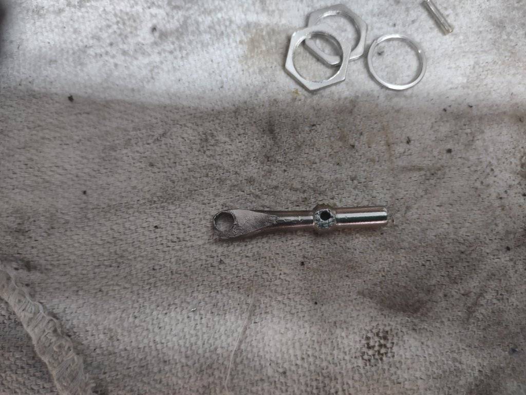

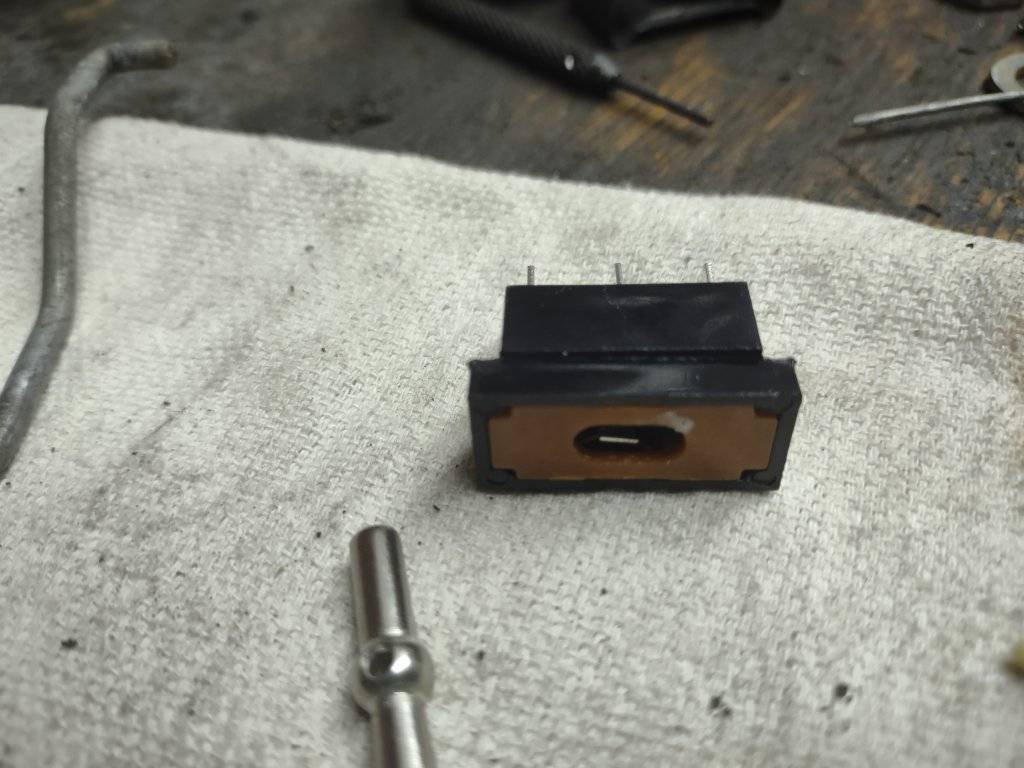

Success. Got a 2 pack of switches. Disassembled one and used a torch to heat the toggle switch. Peened it and drilled a hole. Works great. Not gonna cut the connector off the car. Gonna make wires to plug in the original connect and hook to the new switch.
Online switch $189. My switch $8.
