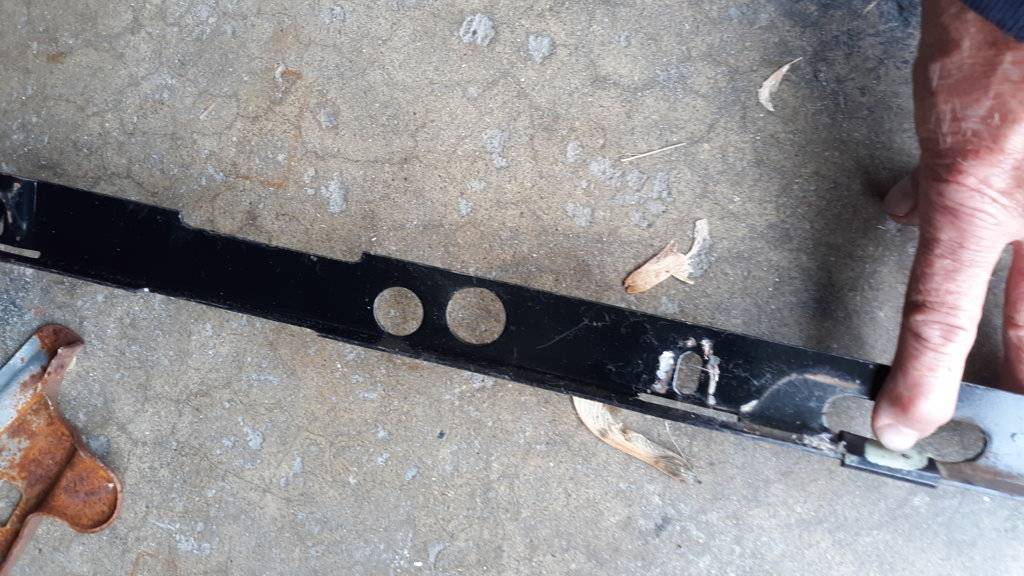

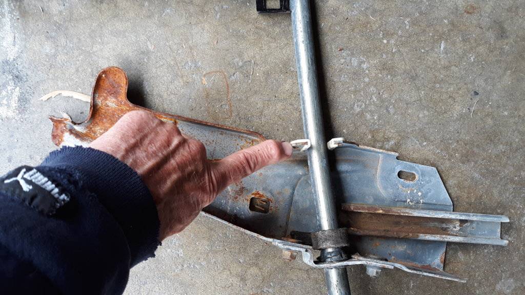

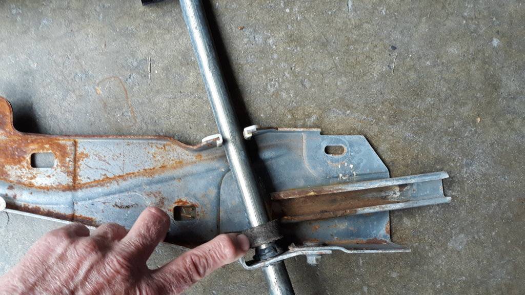

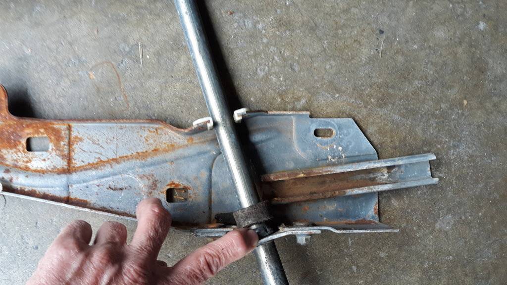

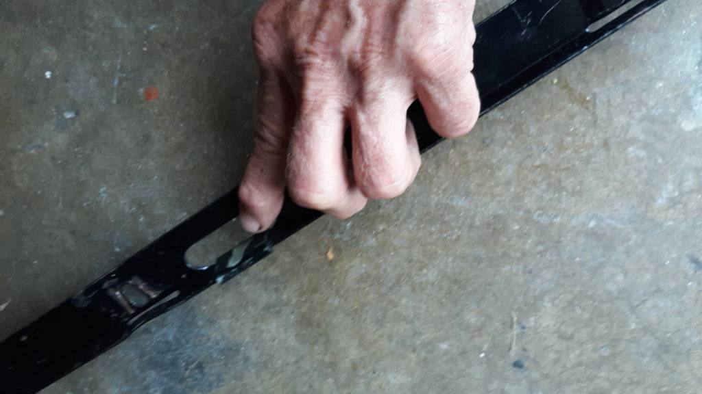

Well i can humbly boast that now I have replaced seals, rollers and adjusted the guides that my 2 doors sound great when closing and no more crash rattling sounds.
I'm very happy with the results of this endeavor:thumbsup:
There are few plastic guides that I have found that break down or off over time. Here are a few common ones pictured. Loose outside mirrors are a problem too.
