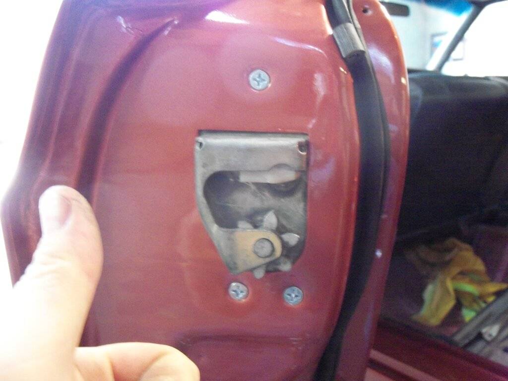

As for the catch in the pillar, not uncommon for it to move inward after years of slamming the door causing the door not to close all the way.
Loosen the 3 screws and move it out ever so slightly and snug 1 screw close the door all the way very gently.
check the gapps. Use a rubber mallet to adjust the catch.
With the door handle button pressed in,close the door all the way to ensure there roller does not snag against the catch and plastic guide rides smoothly upp the catch. Any resistance adjust the catch accordingly.
Then tighten all 3 screws.
Door should close all the way effortlessly with one finger pushing the door.
They are finicky but once set properly worth the agravation.
Hope this helps.
I uploaded the pics for clarity and also it is important to keep the body lines straight when adjusting the door.
