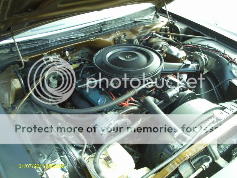

I use one from a '73/4 400. The one with uneven length snorkels. Fits a Holley 4bbl and a pie tin just fine. They usually aren't that expensive either.

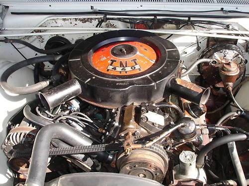

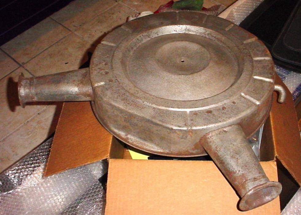

Does the housing you mentioned look like this?
TNT dual snorkel
This is a dual snorkel from a 69 440 TNT engine. A pie tin was on it also. The breather tube is on the side of the housing body.
