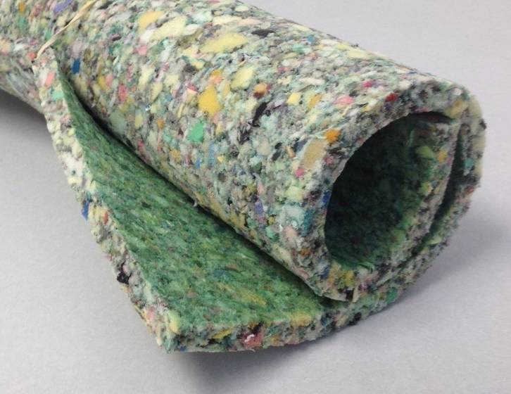

What do you mean by carpet underlay? Foam pad?
Automotive "underlayment" has typically been jute padding of varying thicknesses. The OEM pad under the carpet of my '80 Newport is about 3" thick, which effectively hides the console shift capabilities in the front floor section. In some GM pickups of the later 1990s, the pad is 3+" thick, with foil "heat shields" where necessary between the layers.

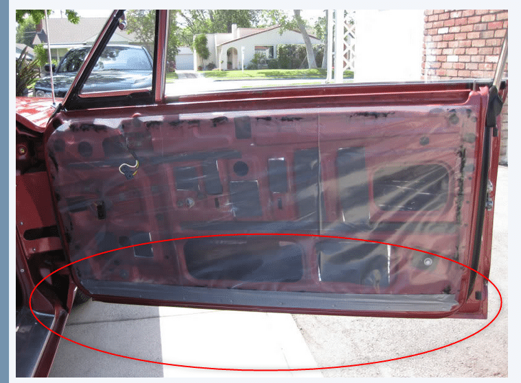

On the subject of "building materials", I saw some hardwood floor underlayment (Pergo and such) that looked like it would make great watershields for the doors. Especially on the GM cars which generally had thick black paper rather than the clear plastic sheet that Chrysler usually used. Might allow some sound deadening, too?

Just checking to make sure that you tucked the plastic into the lower horizontal channel when you installed the door plastic right?
I see it's taped as well but if it rains, I would suspect it might leak onto the door panels if that tape gives out.
