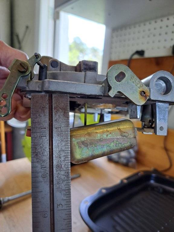

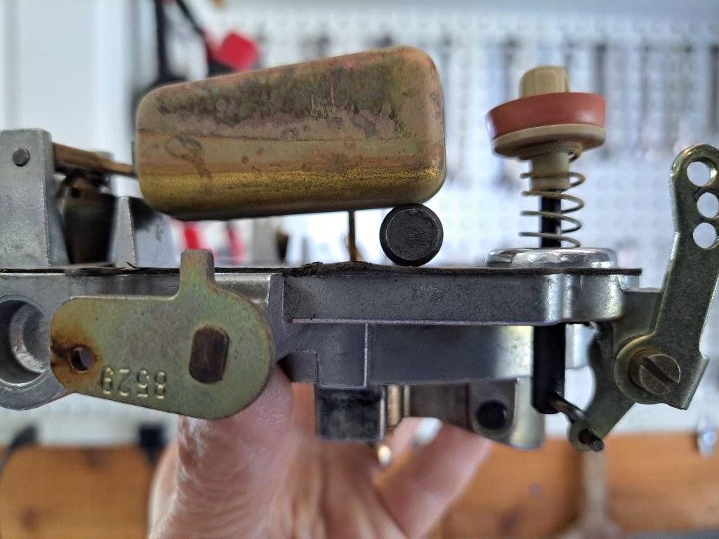

So, this is what I ended up with. 7/16 drill bit. It looks like the float it is setting on it from the image, but it is actually set exactly at 7/16. Initially what I seen was the level was set at close to 3/8 and the drop was at 1-1/8. At test drive noticed only at one time very slight flat spot taking a left turn at 15mph. but it went away once the engine warmed up a bit. I think I can live with this. I'll give it some time and see what happens. I appreciate everyone's support.

I'll bet that will help. I'd still check the pump like I described. Takes just a few minutes for some peace of mind.

Push rod was checked when the pump was installed. Was OK at that time 1k mi. ago. I have future plans to install a serviceable Carter pump with a modified lighter spring. Just haven't got to it yet. Next on the list of things to do is a Firm Feel steering gear (on order, stage 1) and upper and lower control are bushings. :) Thank you everyone.
