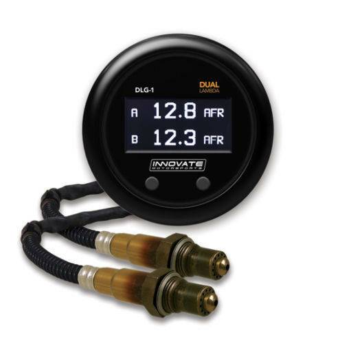

    I was thinking about a wide band O2 sensors [one for each exhaust] so I can play around dialing the carb in. Many use one sensor on one bank which is a lot better than nothing. They are getting cheaper these days.

    Two sensors, two gauges?
