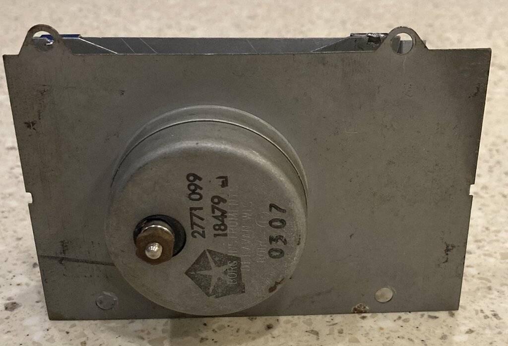

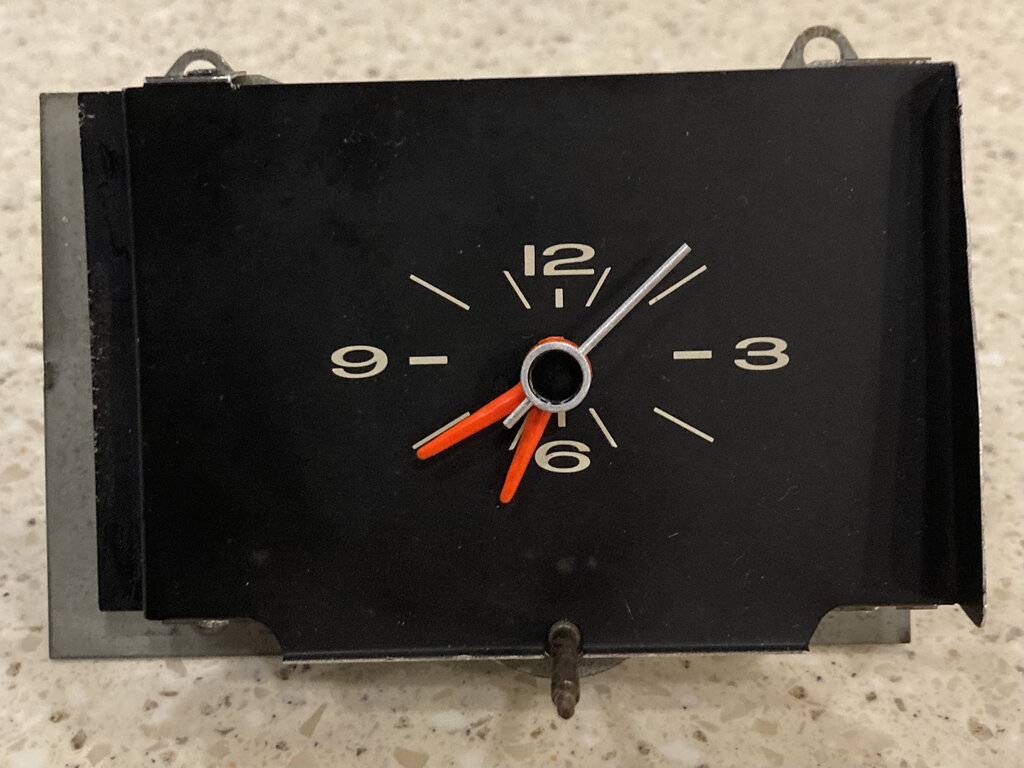

Continuing, I watched the video on the kit manufacturers website and it was very helpful.
Quartz Conversion Kit, Car Clock Repair - Instrument Services Inc.

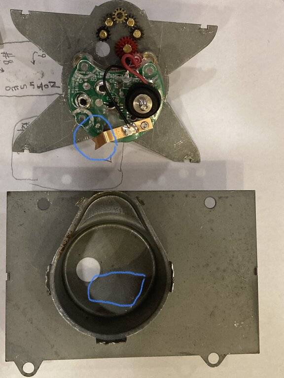

I pressed on the spring steel retaining ‘nuts’ using a 3/16” nut driver, and am painting the hour and minute hands.
I also need to sand the inside of the cover to ensure proper grounding.
I need to finish painting the hands, get it reassembled, tested and close it all up.
Finished the 68 clock for Elwood.
Works as I ran it overnight.
in starting to disassemble the clock for Shamu (69 Fury III vert), the electrical connections don’t match. I will call Instrument Services, Inc. tomorrow to discuss a solution.

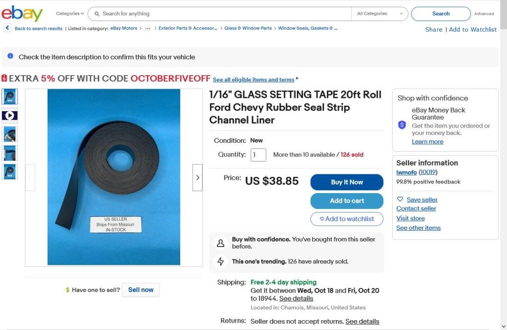

I also need to locate a source for the gasket that I have circled in the diagram below:
I will post a wanted ad.
You are looking for "glass setting tape". It's readily available, you just need to figure out what thickness you need.

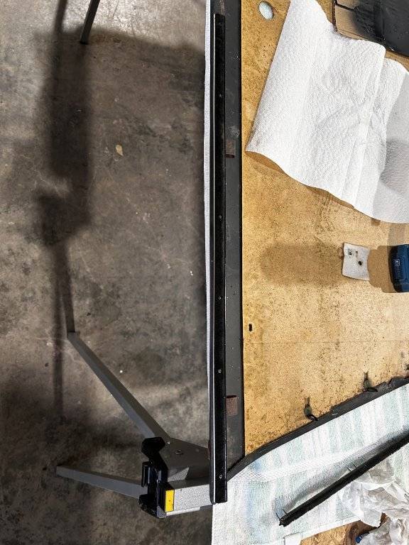

I finally received the glass tape and installed the metal bracket onto the window.
I think it worked out well.
I had soaked the bracket in vinegar, cleaned it up with brake cleaner and sprayed it with a matte clear coat.
Note: the rivets are marked as A & B body and worked perfectly. The rivets are only used on 4 door sedans and maybe station wagons.
I got the window installed today. I was able to save both rollers and the spring steel clips that retain the rollers.
I greased the rollers, shafts and glide paths and installed the window in the reverse order of the FSM.

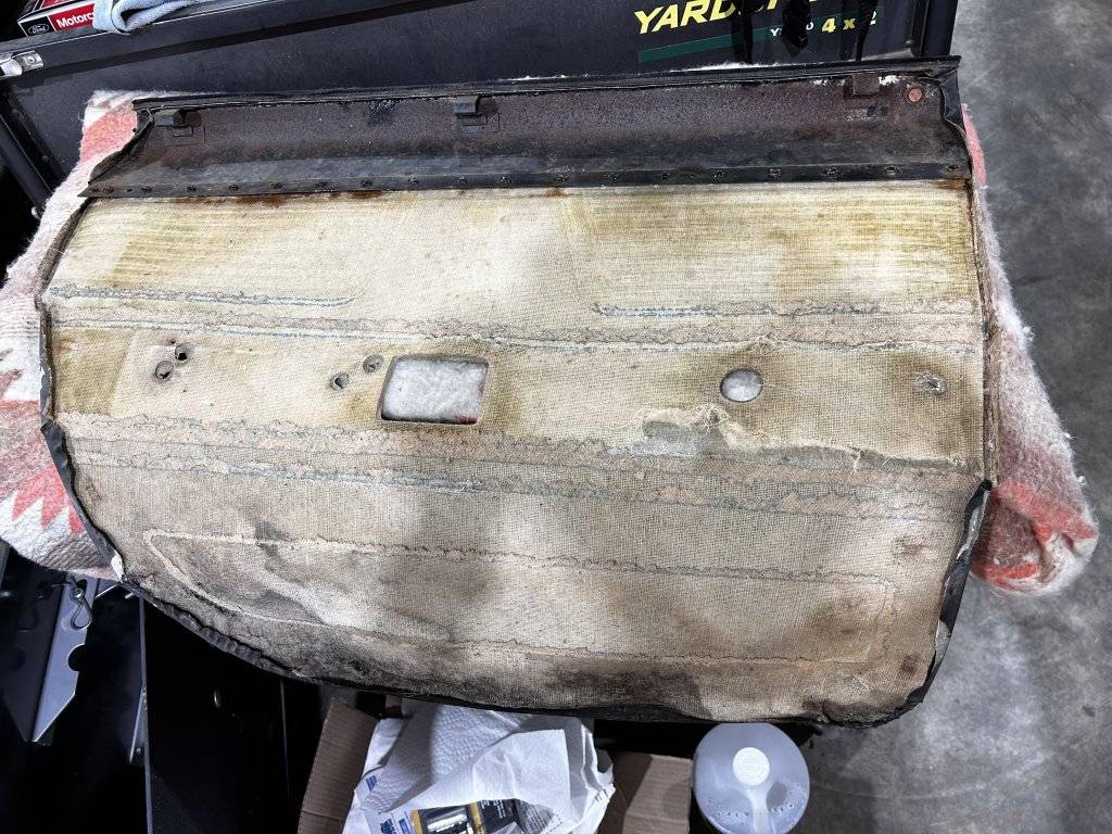

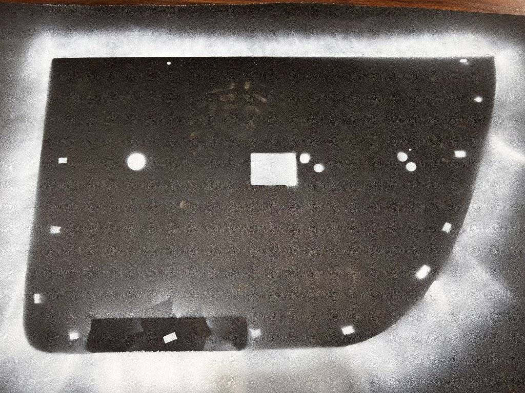

Fabrication of replacement door card in process. The replacement is 2 pieces of 0.060” black abs plastic, glued together with 3M 90 contact adhesive.
I will cut the plastic and the holes with a skill saw and dremel tool.
I got the passenger side door panel installed.

The door panel is in fair shape. If this was going to be a show car, I would order new ones (in addition to a lot of other things).

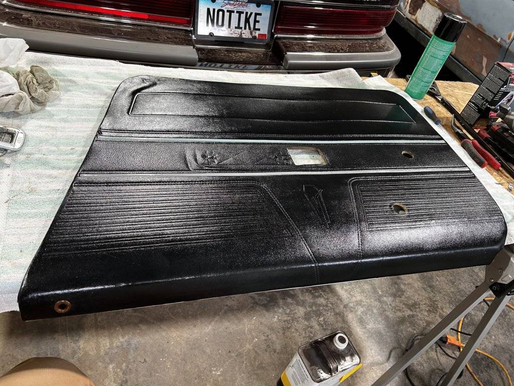

I’m about ready to install the passenger side front door panel. Spent over an hour cleaning it up with Simple Green and had to use some lacquer thinner to remove some overspray near the lock button through hole. After wiping it down, I slathered it up with 303 protectant.
It’s good enough for a daily driver.
On to the rear door panels (cat whiskers and cleanup).
I’m sure that the door panel will turn out less wonderful as in this picture, as the 303 dries.
