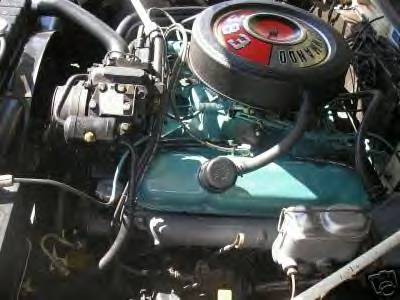

Not sure about '69's but on my '65 everything is body color with the front of the core support getting a blackout treatment. Hood spring is cad plated, hood latch on hood and core support are yellow cad plated.

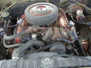

My 69 Dodge
Firewall- Body color - correct
Core Support- Body Color - correct
Inner fenders-black - correct
Hood Hinges-Body color
Hood latch? -99% sure it's black
I think 300 Rag is correct, his Dodge's Engine bay looks near identical to mine (Although I don't have a brake booster)
Might I say you both have very clean Engine bays also.
