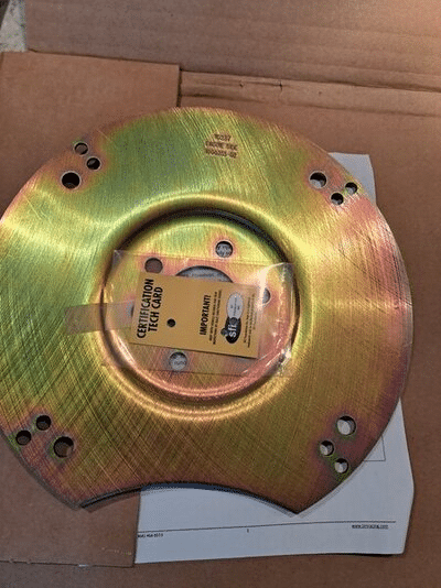

Driver side lower bellhousing bolt to engine is in a different location between an LA and Poly. also use this flex plate for the swap.
I didn't know about that bolt hole difference, my apologies for making it sound too simple
My '67 Canadian Monaco came with poly 318 and 727. In 1986 the poly was swapped for an LA 318 (block casting dates to 1978) and every bolt bolted right up to the 727.
Unless you're talking about a 360 having different bolt pattern than a 318?
