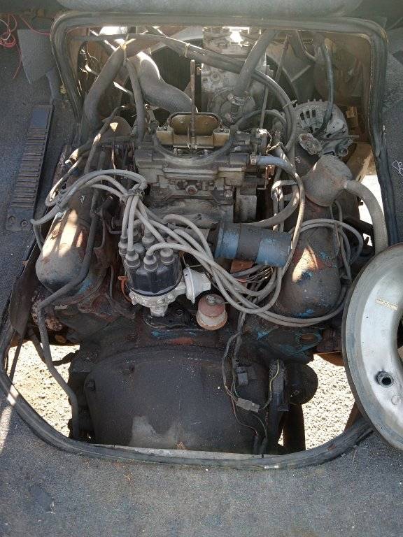

Here's a pic of the 4 barrel 360 I bought. Was in a 76 tradesman motorhome has 55k miles on it runs good and is pretty responsive for how long it's been sitting. I will remove and start rebuilding it in a week or so.

In the pic, it looks like intake manifold may have already been swapped to aluminum, likely edelbrock performer. Also, use the carb that’s on it, it’s an edelbrock. If it needs attention, buy an edelbrock rebuild kit for it.
