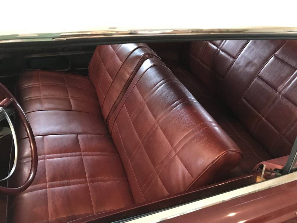

Epic 68 Polara bench seat rebuild for originality

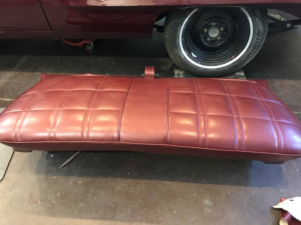

I think it stretched out pretty good. It seems to be settling in. Next time I would probably add 1/4 in each side.

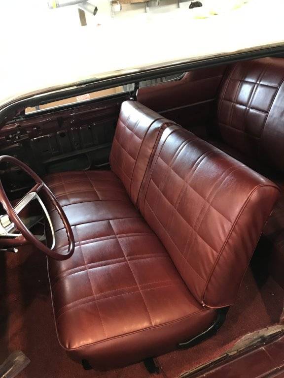

Installed my sliders now I think I will throw it in. And then start on my front seat backs. I should probably throw a copy of my build sheet back under the front and backs where I found them.
No more distractions. I want to finish my seats this weekend.

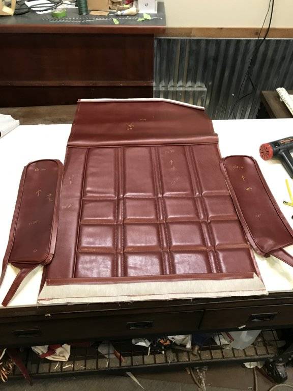

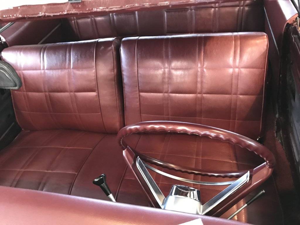

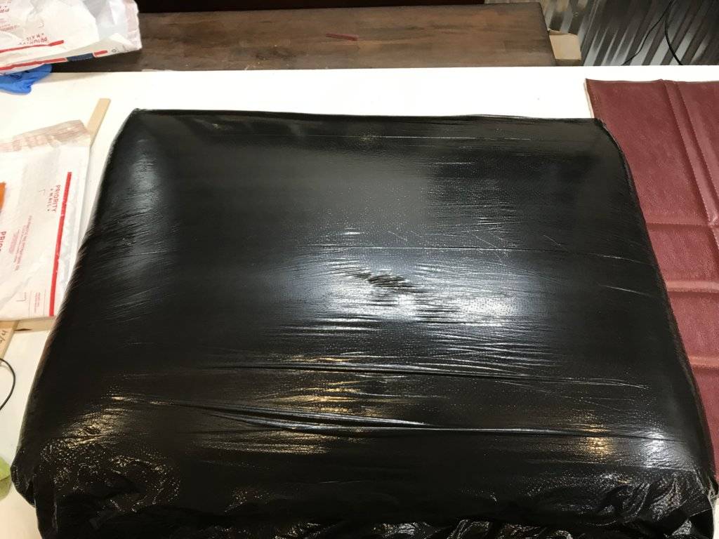

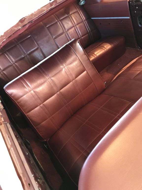

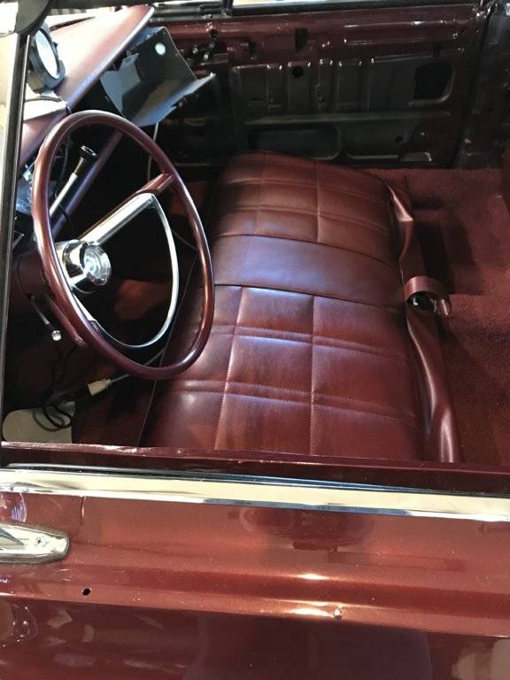

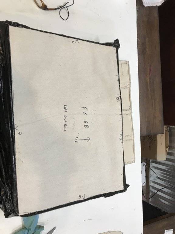

Rears finish and front bench finished front backs in process. I bagged the backs to compress the stuffing so I could verify my patterns. These backs are a little more tricky than the other seats.
Got the damn sausage stuffed. I am going to feel like I have been wrestling alligators tomorrow.
I also may tweak a couple of things in the drivers side. I learned the rear bottom of the seat back isn't quite horizontal. Once it stretches a little I may remove a couple of hog rings and align the pattern a little better.

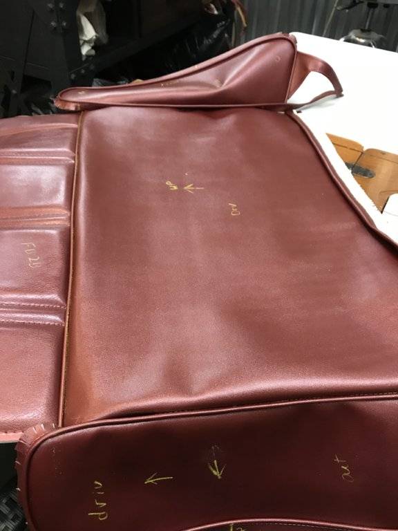

Seam gusset to keep from splitting.

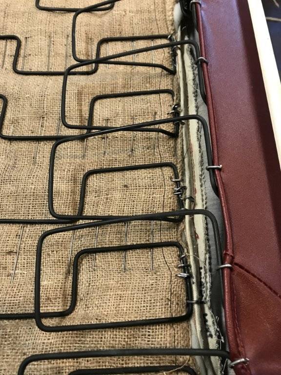

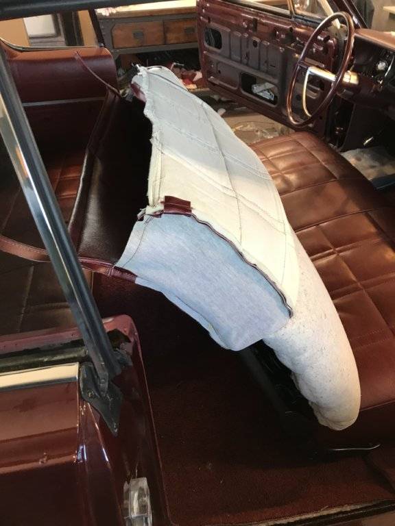

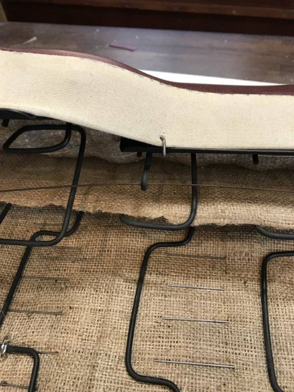

Had to install the seat back to get enough leverage to roll the cover down.
Almost down.
Hog ringed and in place.

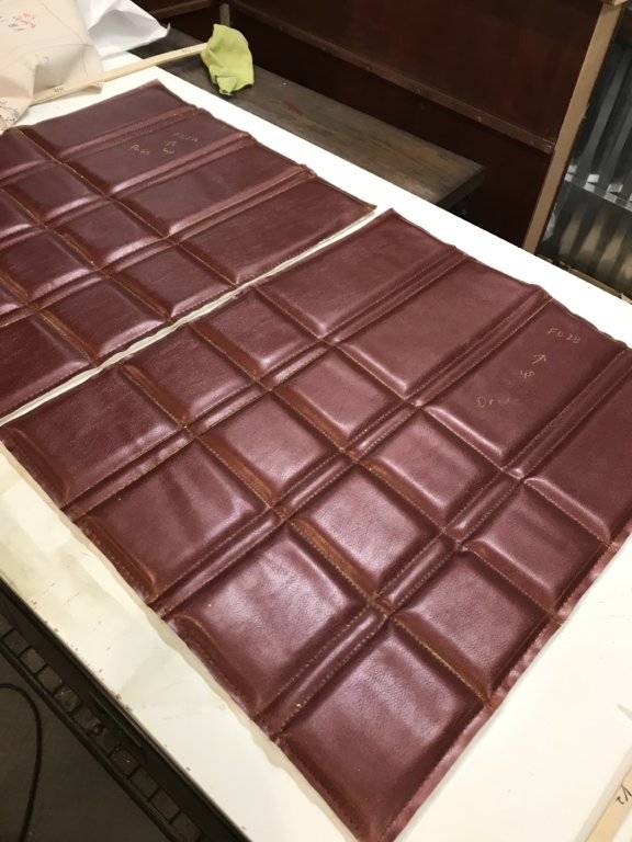

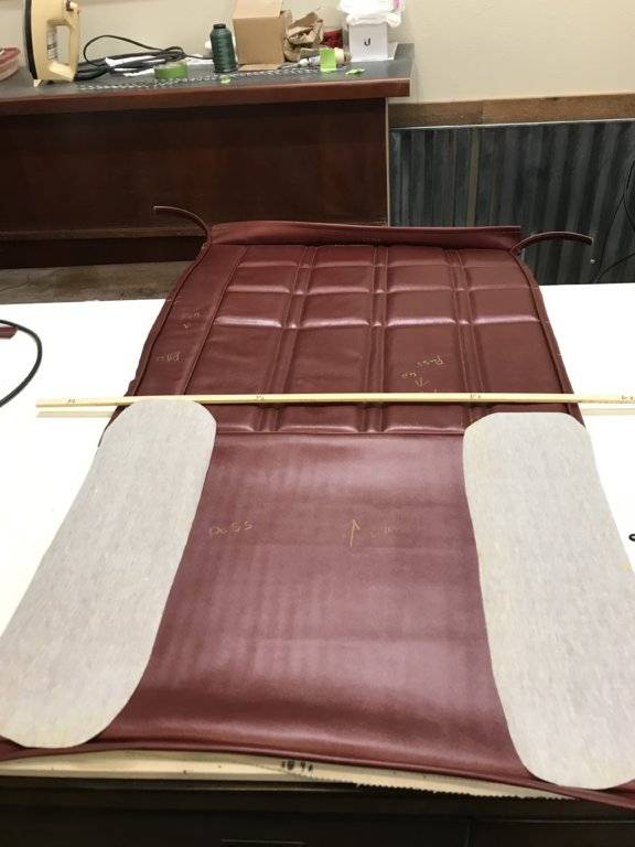

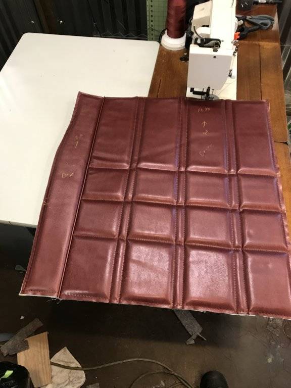

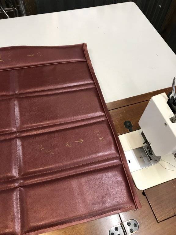

Going to do a time elapse for my second back. So far I have everything cut out and the seat insert quilted.
I will check in when I go in or stop. I did adjust my pattern a little.

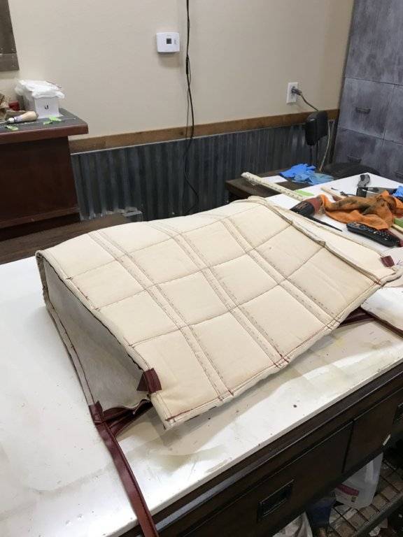

Seat cover is finished. Right at 3 hours to sew together. Did a little different sequence than the last one, it seemed to go smoother.

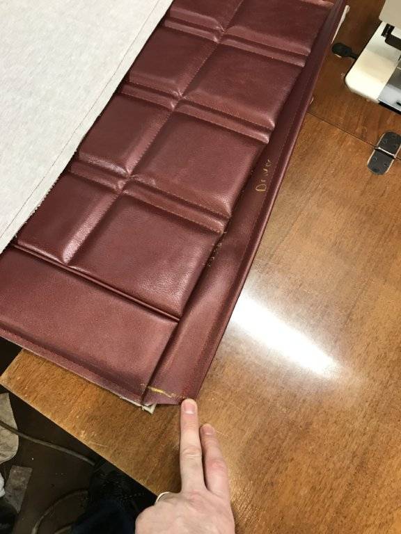

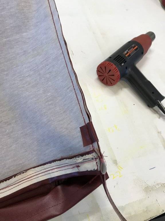

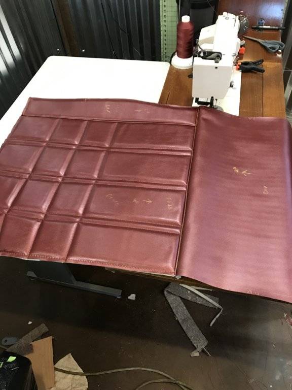

Sewed everything but the sides together.
Then sewed the cording on the side panels. Good choice
Then lined up the top seam on both sides and put some tack stitching in on both sides to hold it in place.

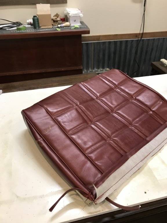

Finished cover inside out
Right side out. Next up stuff it on.

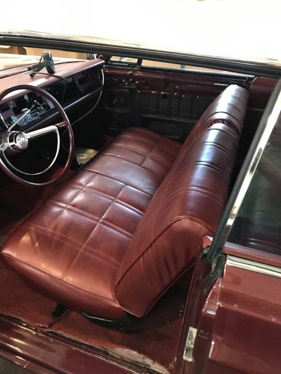

Done. For now. The front backs were the most difficult. Probably because they were the worst off which translated into my patterns. Maybe next winter I will pull them off and put in a little longer outside side panel. It should hav been about 1/2” longer. The transition curve at the bottom wants to pull. I will drive it this summer and decide if it is worth changing.
Because you did all the work, you see all the small items you may want to change or should have done differently. What I see is a awesome job done by a hobbyist that rivals what the pro would have done. I know every time we do a job we learn something, but they look outstanding. Take a bow, job well done sir.:thumbsup:
You did an excellent job on the seats!
